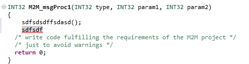

I'm using Eclipse Kepler with 'c' language.
When i'm writing some unknown function, the compiler dosen't show an error as you can see in the attached picture.
Please advise, What should i do??
Thank you.
  • Attachment: FPWy0eA.png
    (Size: 8.94KB, Downloaded 164 times)

Why do you think that the compiler has anything to do with whatever you
see or don't see? What is the compiler output in the build console?
I think you think that the compiler checks what you type: it does not.
Any errors you see while typing are reported by the editor (indexer).

I want to see error when compiling non-exists function.
notExistsFunctionButNoErrorShown();
Thanks.

Hi Kobi,
Have you tried rebuilding index? Like Joost said, it's up to it to show any errors in the editor. Right click on project -> Index -> rebuild.
Also you project may be built correctly, because Eclipse do not clean project before building. It's quite complicated for me to explain, but try to clean your project first (or manually delete Debug or Release folders) and build it again. That should throw errors if you use undefined functions.

I tried to rebuilding index, i tried clean and build again.
now the compiler cannot build because of the not-exists function, he show me error in the console but in the error list i see only generic error and i can't "jump" into the nut-exists function error.
Also, in the code, i don't see any error in the call for the not-exist function.
How can i see the not-exist error in the error list ?
Thank you for the responses.

Re: Problem - Eclipse recognizes non-exists functions [message #1570976 is a reply to message #1527722] Sun, 18 January 2015 05:22 Go to previous messageGo to next message
Update:
When I try to call a function which does not exist outside another function (normal function which works) then an error appears and everything is fine.
If I try to call a function which does not exist from inside another function (normal function which works) then an error L6218E appears but I can not "jump" to it and know where is the error.
Please help!

Re: Problem - Eclipse recognizes non-exists functions [message #1571129 is a reply to message #1571038] Sun, 18 January 2015 07:27 Go to previous messageGo to next message
Win 7 64b, Eclipse Kepler, RVCT 3.0.
I'll try to ask it in other way:
When calling to un-exists function i received L6218E error message.
I can't "go to" the error location in the program.
How can i "go to" the error location?
Thank you.
Re: Problem - Eclipse recognizes non-exists functions [message #1591290 is a reply to message #1571129] Thu, 29 January 2015 07:41 Go to previous message
Update:
When compiling with RVCT3.0 compiler i can't "jump" to this error.
When compiling with GCC compiler all works fine.
It is Bug with the compiler? how can i fix it?
Thank you.
