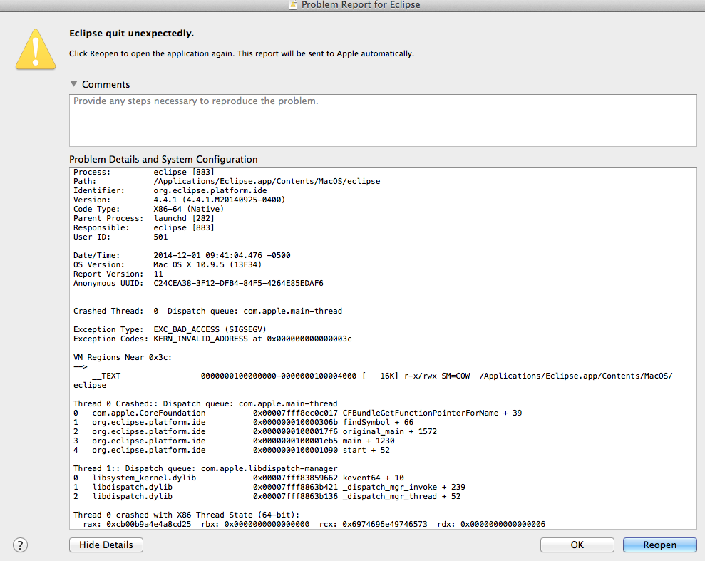

Using an iMac with all the latest updates installed. When I first install Eclipse, it works fine, it's only the next day when I try to open it, it comes up with a message saying it unexpectedly quit and this just continues to happen so wondered if anyone could help me out? Cheers

Re: When I try to open Eclipse the next day, it won't open on my Mac [message #1494517 is a reply to message #1474510] Mon, 01 December 2014 09:44 Go to previous messageGo to next message
I am also having the identical problem. Repeatedly I get a crash and the application will never open.

Re: When I try to open Eclipse the next day, it won't open on my Mac [message #1494541 is a reply to message #1494535] Mon, 01 December 2014 10:02 Go to previous messageGo to next message
This is my log file

Re: When I try to open Eclipse the next day, it won't open on my Mac [message #1494605 is a reply to message #1494541] Mon, 01 December 2014 11:03 Go to previous message
Lindsey Jones wrote on Mon, 01 December 2014 10:02
!ENTRY org.eclipse.m2e.logback.configuration 2 0 2014-11-19 13:08:54.852
!MESSAGE Exception while setting up logging:org.eclipse.osgi.internal.framework.EquinoxConfiguration$1 cannot be cast to java.lang.String
!STACK 0
java.lang.ClassCastException: org.eclipse.osgi.internal.framework.EquinoxConfiguration$1 cannot be cast to java.lang.String
Looks like a bug was fixed shortly after the release you're using:
https://bugs.eclipse.org/bugs/show_bug.cgi?id=445122
