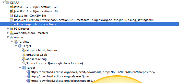

Thanks for your answer, I set the value to null (just to understand the first part, certainly your approach is better), yet I fail to get it right. It is still including the Eclipse Platform part?!?
Sorry, but which value do I have to change here? (pic enclosed)
Re: Targlets: Do not inherit Targets [message #1471709 is a reply to message #1471702] Thu, 13 November 2014 04:29 Go to previous messageGo to next message
I found a way, by overriding the "Eclipse Platform" targlet definiton. I just added a new Targlet "Eclipse Platform" to my targlet list with empty content ...

Re: Targlets: Do not inherit Targets [message #1471728 is a reply to message #1471709] Thu, 13 November 2014 04:44 Go to previous messageGo to next message
Marco,
I should be clear that I do not recommend this, nor even setting the
value to None, and I do mean "None", not null.
Note the what I'm recommending is that you name your Targlet's
Repository Lists using the naming convention below. In particular note
that the active list is selected by
activeRepositoryList="${eclipse.target.platform}"> and that each list
has a name <repositoryList name="Mars">. With that approach
multiple projects can work together and with a single choice on the
user's part, end up with a cohesive target platform.

I really tried hard, and do now understand the way that eclipse.target.platform=None is supposed to work. It does however not work in my environment. Please have a look at this
https://dl.dropboxusercontent.com/u/72943400/2014-11-13_1323.png
Trying this, it ignores ALL my repository lists, even if I explicitely name my own None, just as you did in the Eclipse Platform part. On any other name I always get the IDE local update repo included which breakes with my .target requirements (-> see background part)
Background on my intentions
I understand all your thoughts on what would be better and should be done, but the fact is
  • We develop an e4 based rcp app, built against a defined .target - this is no direct Eclipse project
  • I want to have an up-to-date IDE while completely in development against the .target (currently built using Maven Tycho)
  • I can not refer to the target file itself, hence I want to simply have the p2 repos in the target as repositories in Ooomph, but ONLY those!
  • I want to introduce Ooomph, without currently being forced to change my back-end build system, hence I want to stick to the target!
I think that Oomph is great, and it will become even greater if I could create like a .setup file at the main repo view of my github project easily getting anyone to contribute - which is what I want to do for the Elexis project (https://github.com/elexis/elexis-3-core)
EDIT The screenshot is from another project I am trying to introduce Ooomph ... - same problem here Wink

Re: Targlets: Do not inherit Targets [message #1473254 is a reply to message #1473219] Fri, 14 November 2014 08:16 Go to previous messageGo to next message
Marco,
Comments from Christian suggested he had problems because he'd used
Oomph for a while and had variables stored in his user.setup that are
now normally stored in the workspace.setup... Perhaps that's an issue
for you?
On 14/11/2014 1:45 PM, Marco Descher wrote:
> Ed,

Re: Targlets: Do not inherit Targets [message #1473259 is a reply to message #1473254] Fri, 14 November 2014 08:25 Go to previous messageGo to next message
Ed,
It seems like images I add (i'm writing directly in the eclipse forum) are not shown in your mail client, I think you have the option "Load remote images" disabled (which makes a lot of sense!!!) - please have a short look in the thread itself!
I see, yes for my case it would probably make more sense to activate the target file, thanks for pointing me to this!
There definitely is a setup file, its located in https://raw.githubusercontent.com/elexis/elexis-3-core/master/ch.elexis.sdk/Elexis.setup and this is the resp. target https://raw.githubusercontent.com/elexis/elexis-3-core/master/ch.elexis.target/juno-target.target
Thanks a lot! Smile
Re: Targlets: Do not inherit Targets [message #1473315 is a reply to message #1473259] Fri, 14 November 2014 09:19 Go to previous messageGo to next message
Marco,
From the picture you show, it appears you have only one repository list
called None and that it is present and (although not expanded) and does
have some contents. The picture is also not of the setup you point at
below...
On 14/11/2014 2:25 PM, Marco Descher wrote:
