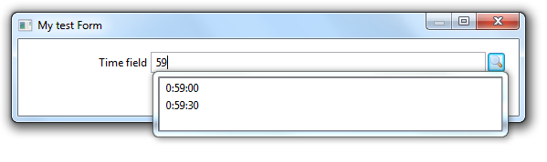

I would do it with a SmartField:
index.php/fa/19887/0/
With a LocalLookupCall that computes the appropriate choices. The Type of the SmartField and of the LookupCall is is a java.util.Date.
Code is here: SmartField_Time_Example
