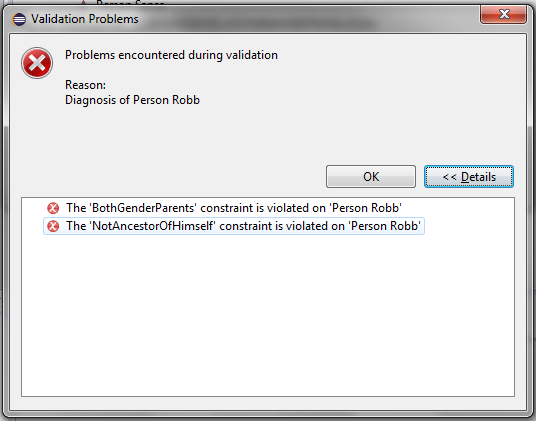

I have included also three invariants in the class Person. It seems the
OCL validation is not right. I have attached a png file with the results
of the validation.

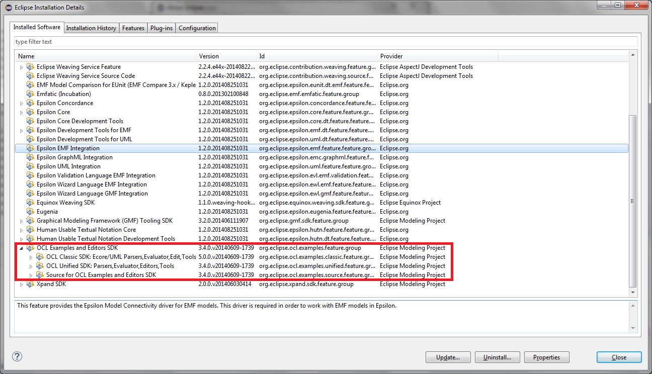

A good repo, although you haven't specified what version of OCL you are
using.
It works fine for me with 5.1.0M3 on 4.5.0M3, 5.0.1, 5.0.0 on 4.4.0.
If it doesn't work for you with one of these, please post your
Help->Installation Details->Configuration.
> of the validation.

I have attached an image of the versions I'm using. And these are the
configuration details are in the .txt file I have included.
If you needed it, I can share my Eclipse bundle.

>> expression is evaluated to true, which is the right result. However,
>> when I execute the expresion in the OCL Interactive Console, the result
>> is false.
>> of the validation.
>> The Eclipse Version I'm using is:
>> Eclipse Modeling Tools
>> Version: Luna Release (4.4.0)
>> Build id: 20140612-0600
>> Thanks and regards,
>> Toñi Reina
>> El 11/11/2014 18:25, Ed Willink escribió:
>>> Hi
>>> Using /org.eclipse.ocl.examples.xtext.tests/model/Fruit.ecore as a repo
>>> and a model containing a Tree with a black and a red Apple.
>>> self.fruits->exists(color = Color::black)
>>> works exactly as I would expect.
>>> I suspect that you have some ambiguous names.
>>> Regards
>>> Ed Willink

Most of your plugins look plausible, although all from Luna SR0 and so
exclude the immediate updates such as OCL 5.0.1, Sirius 1.0.1.
I suspect that Sirius 1.0.1 is the most likely fix since Sirius 1.0.0
was seriously unuseable.
Since it works for me you need to find out which project is causing a
problem.
I recommend uninstalling Sirius, Ecore Tools, Epsilon, ATL, Acceleo,
QVTo, CDO, AspectJ, ... in that order till the problem goes away.
Uninstalling is not always effective, so for more certainty, start with
just OCL Example and Editors, verify that it works for you as it does
for me, then install extra projects one at a time to discover who's
causing the problem.
> Thanks and regards,
> Toñi Reina

>>> I have attached the metamodel and a model example with the problems I
>>> described in the previous post.
>>> Having as context Robb, in the GameOfThrones model, I executed the OCL
>>> expression parents->exists(gender=Gender::MALE) in both Consoles, the
>>> interactive one and the xText Interactive. In the OCL interactive, the
>>> is false.
>>> of the validation.
