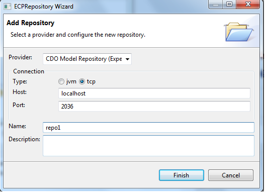

I have tried to run the sample CDO client example and it runs properly with the same repository credentials but when i try ECP demo then i get the above shown exception....
I am running the MasterServer example for CDO
<acceptor type="tcp" listenAddr="0.0.0.0" port="2036"/>
<repository name="repo1">
<property name="overrideUUID" value=""/>
<property name="supportingAudits" value="true"/>
<property name="supportingBranches" value="true"/>
<property name="ensureReferentialIntegrity" value="false"/>
<property name="allowInterruptRunningQueries" value="true"/>
<property name="idGenerationLocation" value="CLIENT"/> <!-- Possible values: STORE | CLIENT -->
<property name="serializeCommits" value="false"/>
<property name="optimisticLockingTimeout" value="10000"/>
Please check the image for adding repository dialog in ECP
connctory type: tcp
host : localhost
port: 2036
description :
Do you have any idea about my problem?
Cheers,
