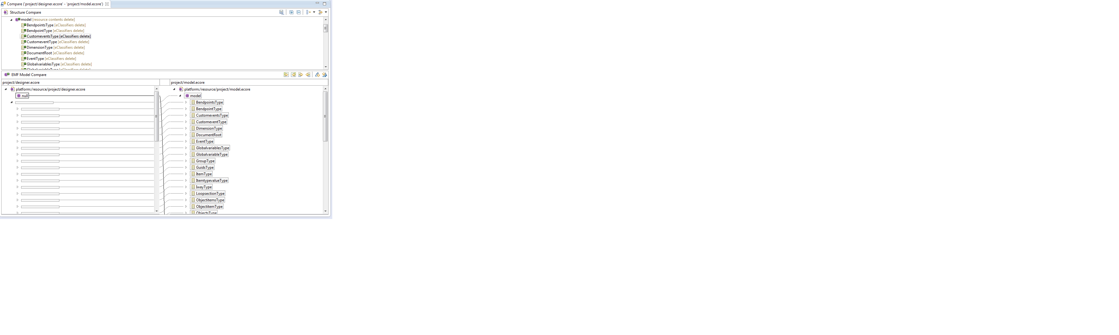

i am looking for emf compare view source code.
when you compare two ecore files using right click compare with each other action, you are getting some compare editor and in the bottom there is two trees with connections ..i am actually looking for how this trees was implemented.
attaching screen shot
  • Attachment: compare.png
    (Size: 59.10KB, Downloaded 143 times)

I think, the class that you are interested in is
org.eclipse.emf.compare.ide.ui.internal.contentmergeviewer.tree.TreeContentMergeViewer.
Several years ago, I also implemented a small viewer with two trees and
lines between them based on the code of EMF Compare back then and
extracted a more general viewer. Not sure though if this still works with
the current version of SWT, but maybe it helps too:
http://sourceforge.net/p/emfmo/code/ci/master/tree/org.modelversioning.ui.commons/src/org/modelversioning/ui/commons/parts/LineDrawingCenterPart.java
Best wishes,
Philip
