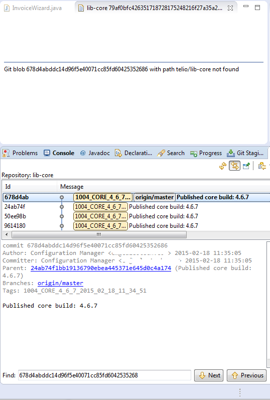

Re: Missing unknown when doing pull [message #1469615 is a reply to message #1468596] Tue, 11 November 2014 14:18 Go to previous messageGo to next message
Hi Matthias,
I can reproduce the exact same error with: EGit/JGit 3.6.0.201411100028
It happens every time we update the submodule and user are pulling that change from the remote repository into there local repositories. Usually there are more commits other than the submodule commit that is pulled, and that was the case here (one more commit).

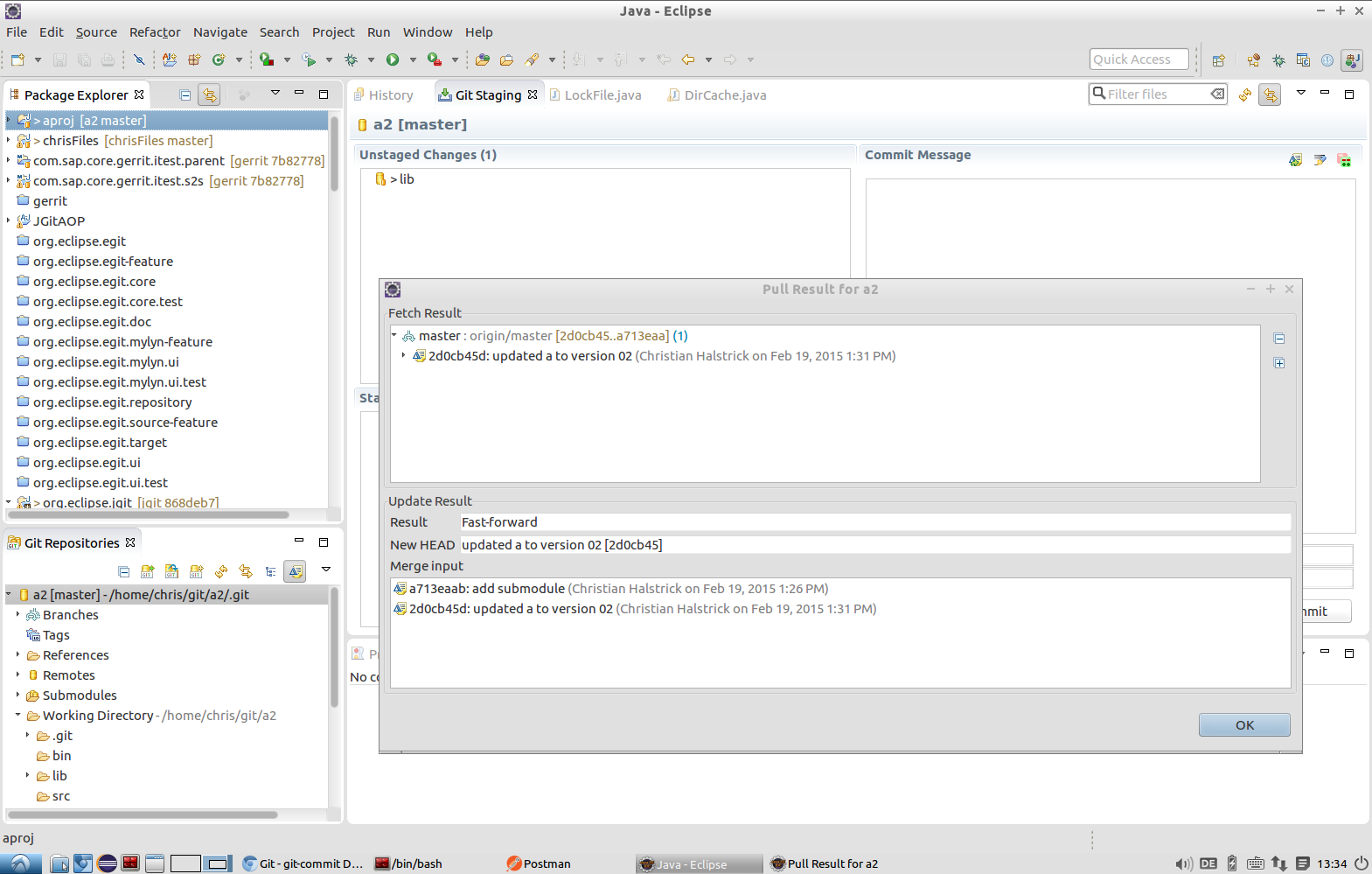

/tmp> # In Eclipse "Package Explorer" view on project "aproj": Select "Pull"
/tmp> # Result: a succesfull "fast forward merge". See attached screenshot
/tmp>

And when I open the commit in the commit viewer and double click on the sub module change it says that it can't find the blob for this change. Se attached picture. And as you can see it is in the sud module history??
I get the feeling that this is a windows only error? Can I turn on some more debugging in Eclipse to get some more information? Can I debug this?

Re: Missing unknown when doing pull [message #1646056 is a reply to message #1645343] Mon, 02 March 2015 15:52 Go to previous messageGo to next message
Hi Christian ,
I tried with the exact same commands as you have and I still got the exception. So I just went through all git settings and found merge.ff=false in my git user settings.
Changing this to merge.ff=true and the error was gone Wink.
So setting merge.ff=false in Git User Setting triggers the missing unknown exception when pulling commits containing sub modules changes as far as I can tell.
After the exception do a Team ->Reset (--hard) and change the Git User Stetting to merge-ff=true and Team->pull will succeed.
I tried using "--no-ff" with native git (which I believe is the same) and it worked.
I used:
$ git config branch.master.mergeoptions "--no-ff"
and then when I did the pull in the a2 repository I got the following output.
man@SUPERMAN /f/git/a2 (master)
$ git pull origin master
remote: Counting objects: 3, done.
remote: Compressing objects: 100% (2/2), done.
remote: Total 2 (delta 1), reused 0 (delta 0)
Unpacking objects: 100% (2/2), done.
From file:///F:\git\a
* branch master -> FETCH_HEAD
8d209df..a0e006a master -> origin/master
Fetching submodule lib
remote: Counting objects: 7, done.
remote: Compressing objects: 100% (4/4), done.
remote: Total 6 (delta 1), reused 0 (delta 0)
Unpacking objects: 100% (6/6), done.
From file:///F:\git\lib
db71fdc..007d5b3 master -> origin/master
* [new tag] VERSION_06 -> VERSION_06
* [new tag] VERSION_04 -> VERSION_04
Merge made by the 'recursive' strategy.
lib | 2 +-
1 file changed, 1 insertion(+), 1 deletion(-)
The "--no-ff" option did change the output from git pull compare to when -"--no-ff" was not set. But the end result is the same for both cases...
I tell the developers here to set merge.ff to true and hopefully this will fix these issues for us.
But I guess JGit should be enhanced (in the future) to support -merge.ff =false together with sub modules as well since as far as I can tell it works with native git.
Br,
/Mattias
[Updated on: Mon, 02 March 2015 15:52] by Moderator
Re: Missing unknown when doing pull [message #1646172 is a reply to message #1646056] Mon, 02 March 2015 17:12 Go to previous messageGo to next message
