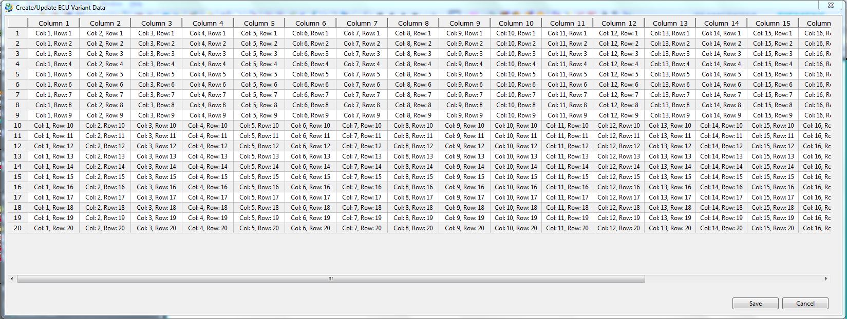

I am calling NatTable from the dialog as below:
MyNatTable natTable = new MyNatTable(composite);
MyNatTable extends from NatTable as below:
public class FV9VSCSECUVarNatTable extends org.eclipse.nebula.widgets.nattable.NatTable
I am using the class constuctor as below:
public MyNatTable(Composite parent)
super(parent,true);
In this case I am getting composite with default NatTable (please check in the attached screenshot). When I am trying to add my contents it is coming below this default NatTable.
How to avoid this default NatTable from being added to composite?

If you extend NatTable you should check which constructors you need to implement accordingly. It seems you only implemented the constructor that creates the default NatTable stuff.
Although I completely don't understand why you are extending NatTable instead of using and configuring it.
