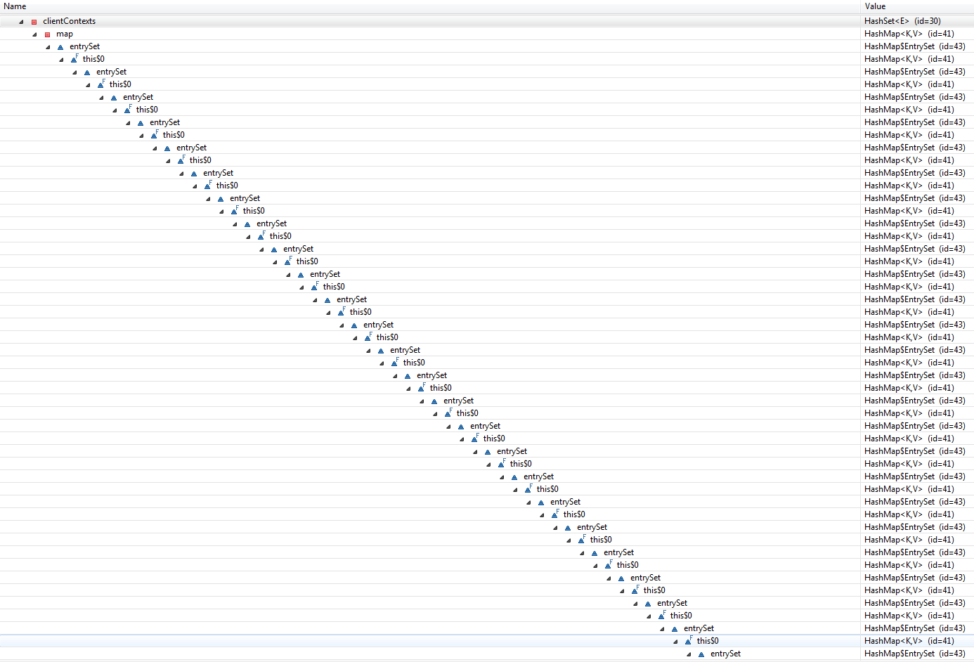

I do see something a bit peculiar in the ClientContextManager, more precisely the Set<IClientContext> clientContexts : it contains a total of 677 EntrySets, all of which have the same id and point to the ClientContextManager itself (see attached screenshot). I don't know if this is an expected behaviour ?
ClientContextMap, on the other hand, remains empty.
Something I should take a look at ... ?
I think you're misinterpreting what the debugger is showing. A HashSet
is implemented internally as a HashMap in which the members of the set
are just the map's keys trivially mapped to something unimportant.
Your screenshot shows a cyclic expansion of the bidirectional
references between the HashSet, its HashMap storage, and that map's
EntrySet which is just the original HashSet instance.
If you engage the Variables view's "Show Logical Structure" toggle
option in the view toolbar, then it will present the set as an array of
its members, which is more useful.
There will not be 677 client-contexts in the set. How many are there
actually? And does any of them bear your context's ID?
This suggests that either (a) your client-context was never loaded from
the extension point because your plug-in isn't in the run-time OSGi
configuration or it couldn't be resolved because of some dependency
resolution problem, or (b) a previous attempt to match it threw an
exception that got the context booted from the system (see the
exception handling in the
ClientContextManager::getClientContextsFor(EObject) method).
> Thomas
> <image>
Re: [EMF Validation] My Dynamic constraint provider gets never called [message #1473233 is a reply to message #1472092] Fri, 14 November 2014 07:55 Go to previous messageGo to next message
Thanks a lot for the hint ! Infact I made a very stupid mistake : I was testing the Validation framework outside of my RCP-application and, of course, the plugin.xml was not read.
Sorry for bothering, I'm doing a lot of testing for RCP recently but I'm very new to OSGI and the Eclipse environment.
Clientselector and constraint are being called now as expected.
Thanks again,
Thomas
