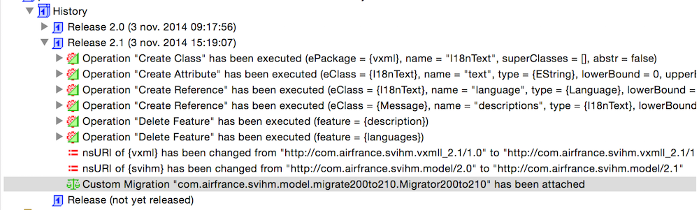

As far as I have understood the method :
public void migrateBefore(Model model, Metamodel metamodel) throws MigrationException {
// Put your code here before migration
It should receive the metamodel before modification has been applied. Right ?
What could be the reason why I currently receive the expected metamodel and not the initial ? Is it a problem of URI in historic ? Should the 'Custom Migration' be at the beginning of the release ?
I have also a model which refer to the new meta model too... While no migration has been done... Strange behavior....

Re: [Edapt] A question about custom migration [message #1463750 is a reply to message #1463426] Thu, 06 November 2014 17:19 Go to previous messageGo to next message
Ok.
So in my attached sample (customeMigration.png), my Custom Migration will always receive the same metamodel in the before and after method, because it stands at the end of my release ?
It would mean that if we want to store the data in the model before migration, we must have a custom migration at the beginning of the release to remember of the values, and another customMigration at the end of the release to transfer the information ?
Right ?
Re: [Edapt] A question about custom migration [message #1467828 is a reply to message #1463750] Mon, 10 November 2014 05:44 Go to previous message
no, you need to attach a custom migration to the operations that destroy
information and read in the data before and write out the data after the
migration in the implementation of these custom migrations. In your case
probably the two deletes.
Maximilian
Am 06.11.2014 23:19, schrieb Olivier Prouvost:
> Ok.
> Right ?
