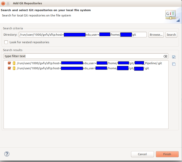

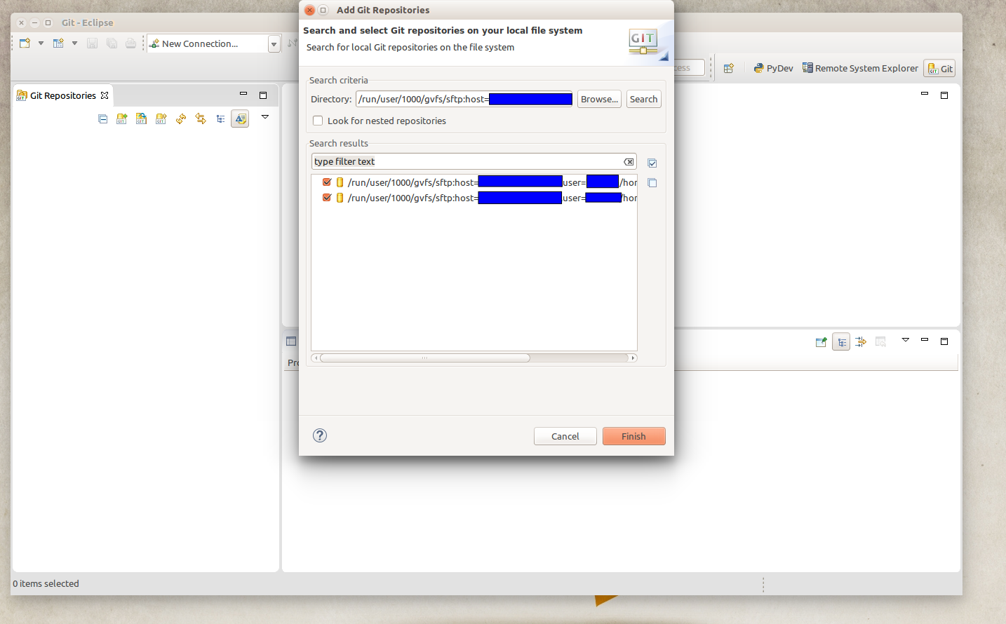

I already have cloned the repository to server-A using terminal via ssh. Using the git perspective in eclipse, when I try to add these repositories by navigating to the local mount point of server-A and then to git folder, I can see two repositories found by eclipse but these are not added after I press 'finish' button. [Photo Attached- Adding_Git_mod]

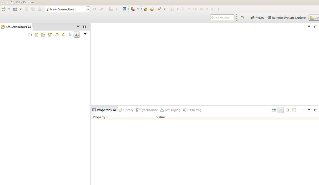

I followed your advise too, to clone the repositories using Eclipse. For this, I mounted another server (Server-X) to my Ubuntu desktop and then used "Clone Git repository" steps to clone one of the repo. from our central server. It did added a repository to the Server-X and I can confirm because I can see the files in nautilus/window explorer but again no git added to eclipse under "git repositories". [Photo Attached - Empty_Git]
So it seems that Eclipse is identifying as well as cloning the gits properly to the servers (A and X) mounted on my desktop. Its just that these are not added or listed in Eclipse. Any suggestions?

May it is because when you are using the gvfs feature then the pathes contain special characters like = and : . Maybe this disturbs EGit. Can't you mount more traditionally that you have a more standard path?
Youre screenshot Adding_Git_mod.png cuts off where it gets interesting. I am interested in the full path. Especially how these two pathes differ. Can you cut and paste the two urls here?

Attached the new photo. Pasting urls:
Directory Path
/run/user/1000/gvfs/sftp:host=abc.xxx.yyy.edu,user=obama/home/obama/git
GIT PATH
/run/user/1000/gvfs/sftp:host=abc.xxx.yyy.edu,user=obama/home/obama/git/SOME_PIPELINE/.git
/run/user/1000/gvfs/sftp:host=abc.xxx.yyy.edu,user=obama/home/obama/git/TOOLX/.git
