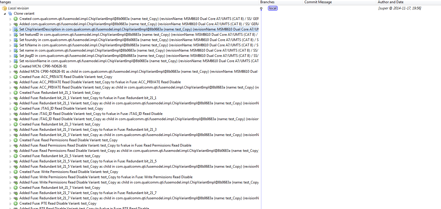

Hi Maximilian,
I tried using the beginCompositeOpetration and I see that there is a handle and it basically groups all my operations under one operation. But what I would like to see is to avoid all those suboperations to be stored as separate objects in the change package and have one operation object for all of them. Because in our clone operation we have about 16k operations (including creating new objects setting references and attributes) the change package is very heavy. As a result it effects memory consumption and performance for most of the operations.
Do you know how I can wrap these basic set/create/add operations in one single operation? I tried using IUndoableOperation and EMFCompositeOperation but didn't have any success, every time I see all the changes stored separately as one operation. I attached the screen shot of history browser that shows the composite operation and all the operations under it.
Roza

Re: [EMFStore] Composite operations [message #1481919 is a reply to message #1477702] Fri, 21 November 2014 05:26 Go to previous message
as you point out correctly, Composite Operations only group all basic
operations into one operation which is handled atomically during
conflict detection and merge. This is the intended functionality.
To create one single operation just by creating a composite operation is
conceptually not possible. You need to store the information about the
fine-grained changes somewhere. However it is often possible to reduce
the number of operations in a composite (e.g. by normalizing or by
regrouping your changes). However this is not a feature that is publicly
available.
