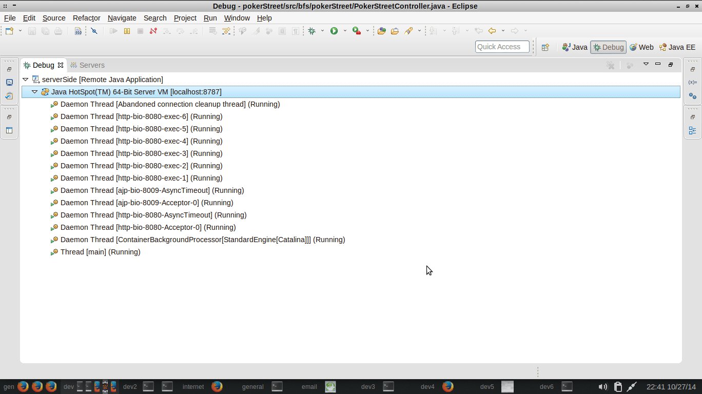

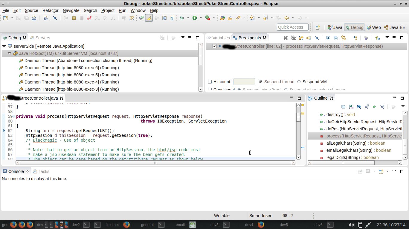

After clicking on the Debut button, the 'Debug Configurations' window is dismissed and I am in the debug perspective window [attachment: 'debug_perspective_jimAnderson.jpg] . At the top of that window, the 'disconnect' button lights up, implying that connection has been made with the tomcat server. I also see the threads which are shown in the 'threads_jimAnderson.jpg' file, where the panel showing the threads is maximized. The design perspective also shows that the break point has been set.
