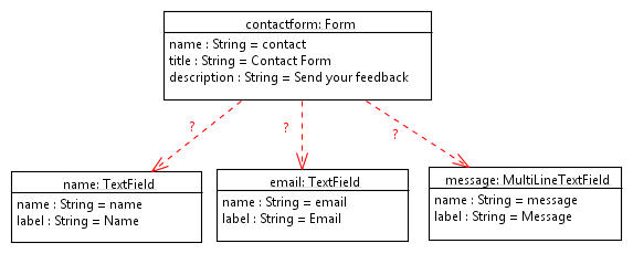

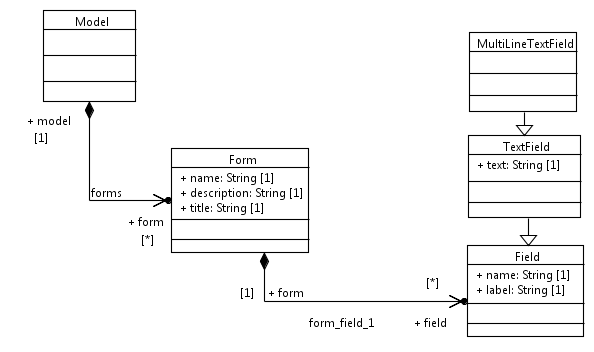

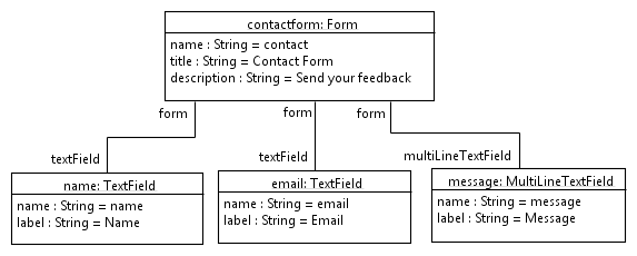

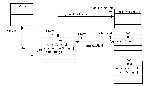

I've created a Class Diagram with a few Class wit Papyrus 0.10.2.v201402281227 on Eclipse Kepler. Then I'd like to use them as InstanceSpecification as follow.
Case_1: (It is OK)
- ClassDiagram index.php/fa/19681/0/
- InstanceDiagram index.php/fa/19683/0/
Case_2: (It is no OK)
- ClassDiagram index.php/fa/19680/0/
- InstanceDiagram index.php/fa/19682/0/
- EclipseProject Please find as attachment
In second case, It can not be connect two InstanceSpecification block with InstanceSpecification Link, however everything is OK in first case. The links was shown as dependency link in red. Is it that expected behaviour?
Ibrahim

It looks like Papyrus expects an allocatable association between the immediate classes to set the instance association. This will be asked before setting the instance relationship. The question does not come if you try to use an association along the inheritance path.
In order to cover such model cases papyrus should have to do a recursive search of allocatable associations in the classes of inheritance.
