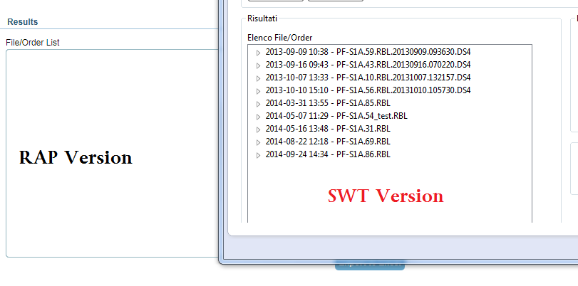

Re: Tree Field in Scout Kepler [message #1454595 is a reply to message #1450527] Tue, 28 October 2014 11:09 Go to previous messageGo to next message
Hi all,
I have another problem with this type of field, I have found two different behaviors between SWT and RAP interface:
  • In SWT when I load a new set of information, the tree field is correctly populated and works fine
  • In RAP, when I do the same operation to obtain the same result, the tree field remains empty
In the first time, I thinked that the problem is linked with these two istructions:
          getTestTreeField().getTree().disposeTree();
          getTestTreeField().getTree().initTree();
and for this reason I commented these two rows, but nothing has changed in the behavior. The code is in the first message of this topic.
This is the result in these two interfaces:
index.php/fa/19702/0/
Can someone help me understand this issue?
Thanks in advance for any help
  • Attachment: Cattura.PNG
    (Size: 19.33KB, Downloaded 304 times)
[Updated on: Wed, 29 October 2014 04:39] by Moderator
