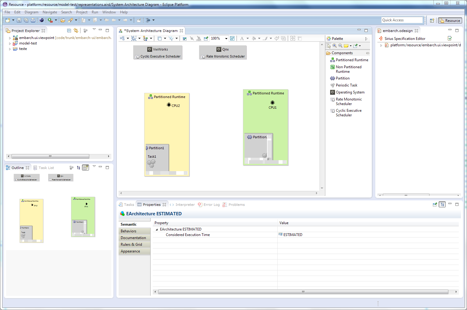

When I am inside a container node and it does not fit its contents, strange scrollbars appears. It is not the operating system default scrollbar and looks very ugly Crying or Very Sad . It seems to be some rendering issue. I attached an image showing it.
Does anybody have a solution?

Le 20/10/2014 14:19, Vinicius Souza a écrit :
> When I am inside a container node and it does not fit its contents, strange scrollbars appears. It is not the operating system default scrollbar and looks very ugly :cry: . It seems to be some rendering issue. I attached an image showing it.
The Sirius editparts which displays those scrollbars inherit from
org.eclipse.gmf.runtime.diagram.ui.figures.ShapeCompartmentFigure which
creates a
org.eclipse.gmf.runtime.draw2d.ui.internal.figures.AnimatableScrollPane
with its org.eclipse.gmf.runtime.draw2d.ui.figures.ListScrollBar.
You could choose to implements some specific scrollbars (or reuse other
kind of scroll bars from draw2d) but you will have to provide your own
editparts and figures to change this behavior.
Maxime - Obeo

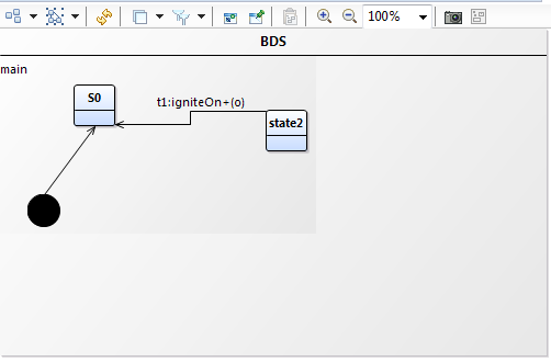

I'm having the same problem. Attached is an image showing that when I create a container in another container, it will not get auto sized or auto fit to the parent container.
index.php/fa/25427/0/
Any solution ?
Parsa

Le 26/03/2016 19:00, Parsa Pourali a écrit :
> Hi,
> Any solution ?
> Thanks,
> Parsa
IMO, this is related to your other post on the auto-fit or regions and
the size expression in the VSM.
This thread deals with the GMF/Draw2D scrollbar rendering (in diagram
containers) which is the same on MacOS, Windows and Linux but is
different than the scrollbar displayed in Eclipse views (system dependent).
Maxime - Obeo
