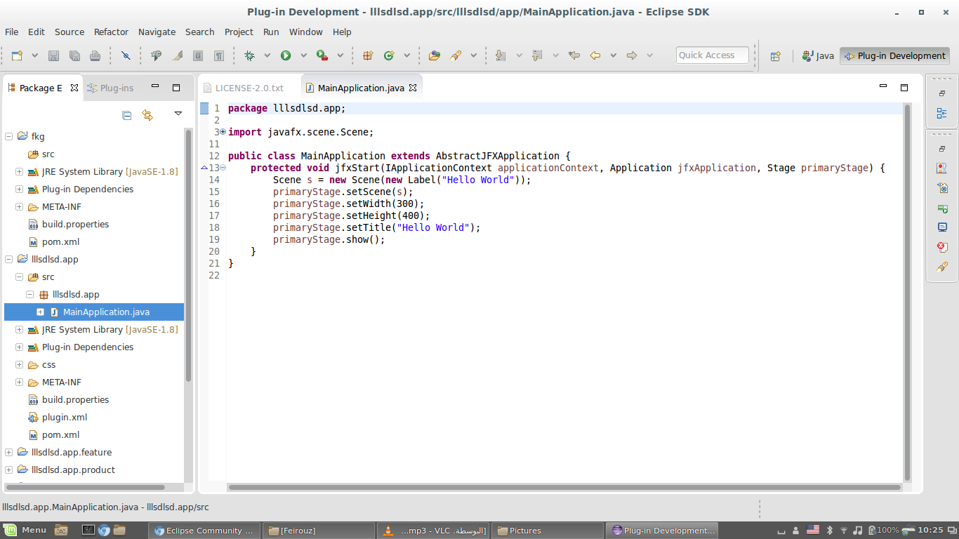

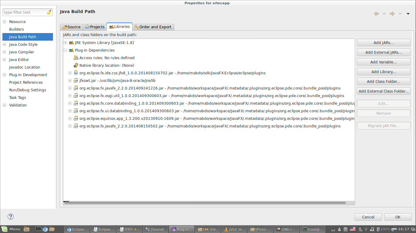

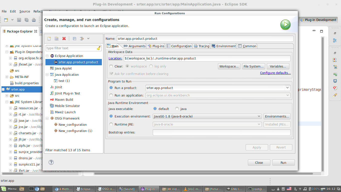

1- for the first wizard it is generating four projects which MR. Tom Schindl had explained in his blog http://tomsondev.bestsolution.at/2012/12/10/my-recommended-project-structure-for-javafx-e4-projects/, but when i looked at the Run Configuration of the launch i realized that it is running as an Eclipse Application index.php/fa/19589/0/, (and i need to start my system as an OSGI Framework), and notice this, there is a plug-in dependencies which looks like this index.php/fa/19590/0/, and the main class is extending an AbstractJFXApplication class and using an jfxStart method (not a standard JavaFX App)!!!! index.php/fa/19591/0/.

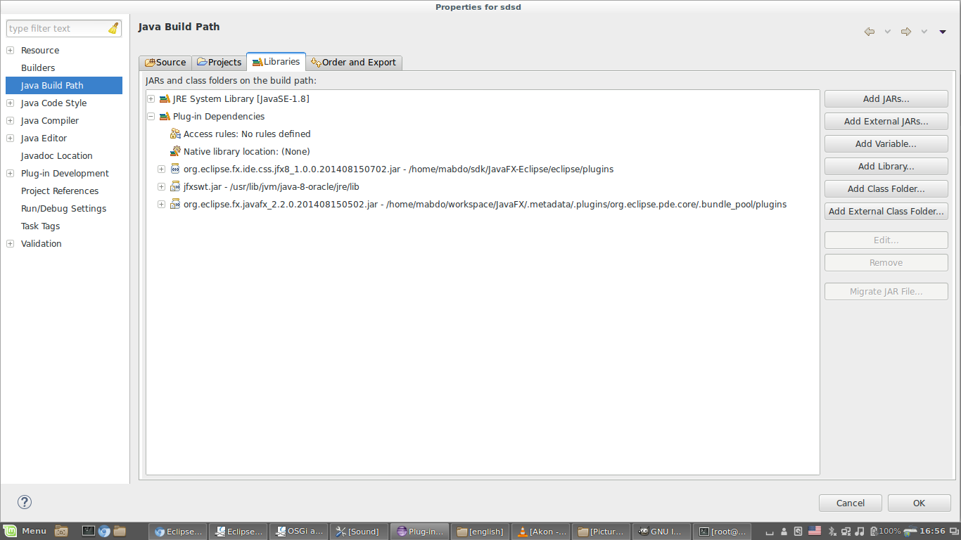

2- for the second wizard the generated project has the same structure as an plug-in development project (I SUPPOSE) adding the plug-in dependencies that looks like this index.php/fa/19592/0/.
