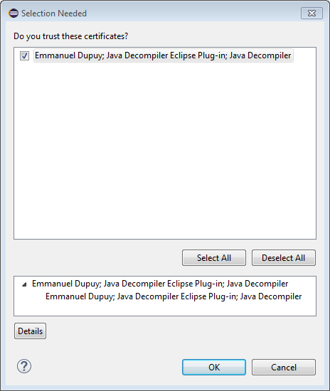

when I try to install JD-Eclipse with OOMPH from "jd.benow.ca/jd-eclipse/update" then I get the following error:

I think the problem is that the the "Do you trust these certificates" does not popup what is always coming up when you try to install it interactively.
Any ideas?

Lasse,
For me when I try to install jd.edi.eclipse.feature.feature.group from
http://jd.benow.ca/jd-eclipse/update the license dialog comes up asking
about:
JD-Eclipse is free for non-commercial use. This means that JD-Eclipse
shall not be included or embedded into commercial software products.
Nevertheless, JD-Eclipse may be freely used for personal needs
in a commercial or non-commercial environments.
And then a trust dialog comes up and it all installs fine.
Is that the IU you're trying to install? (Keep in mind that to install
features, the name ends with .feature.group.)
