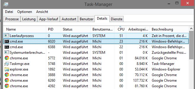

If I start the eclipse.exe by double click in explorer, I get an explorer.exe which consumes 25% of my cpu (one core) and nothing changes this until I restart my system. Same thing happens when I try to start eclipse.exe via console (cmd), only difference is a cmd.exe in taskmanager consuming 25% CPU.

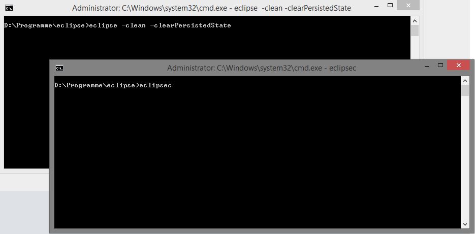

A few things i tryed:
- complety cleaned my system of all java installations and eclipse to da a "fresh" restart (again) -> nothing
- reset PATH value to default -> nothing (even after another reinstall of java with clean PATH)
- set path to javaw.exe in eclipse.ini (-vm -> next line the path)
- start ecplisec.exe over cmd -> not a single output line displayed in the prompt
- start eclipse.exe with parameters -clean or -cleanPersistedState or even both -> again not a single output line ... just a cmd.exe consuming my CPU until I restart the system
I attached some screenshots of my problem to this post.

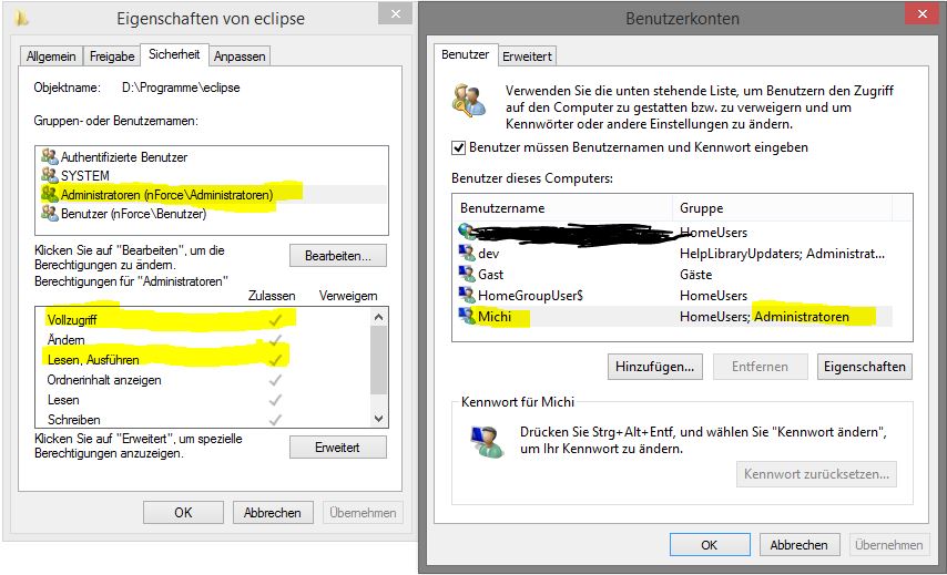

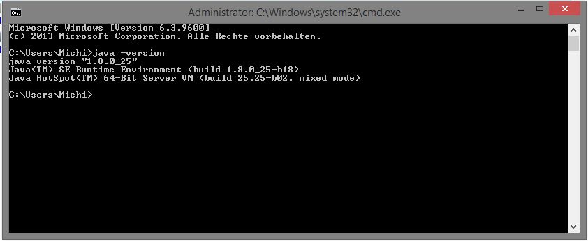

Which file did you download from Eclipse.org? Is it 64-bit? Is your Java also 64-bit? Do you have Read and Execute permissions on the entire eclipse directory and everything under it?
Re: Eclipse wont start (yet another thread) [message #1445172 is a reply to message #1445057] Wed, 15 October 2014 00:35 Go to previous messageGo to next message
The file i got from eclipse.org is named "eclipse-java-luna-SR1-win32-x86_64.zip", so it should be 64-bit.
JDK Setup is named "jdk-8u25-windows-x64.exe" (also tryed 8u20).
I made a screenshot of the command prompt output of "java -version", maybe it's a hint ("eclipse_3.jpg")
I also checked the permissions (just to be sure) and everything looks ok. As an administrator i got unlimited access to all the files (see attachment "eclipse_4.jpg", tho it is in german I hope it's somehow self-explanatory)

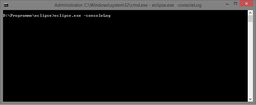

Re: Eclipse wont start (yet another thread) [message #1446919 is a reply to message #1446338] Fri, 17 October 2014 10:06 Go to previous messageGo to next message
Hey Eric,
after a couple of minutes waiting i just got nothing ... again (see attached screenshot)
  • Attachment: eclipse_5.JPG
    (Size: 25.07KB, Downloaded 534 times)
