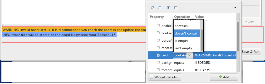

Re: Strange behaviour of text assertion [message #1444664 is a reply to message #1444651] Tue, 14 October 2014 07:25 Go to previous messageGo to next message
I expect your tests to be failed with this text. Does your test fail with this text? What does it mean "commands are not working correctly"?
Did you add that verifications by assertion and verification mode while recording? If you did, could you please attach screenshot when you add that verifications.
[Updated on: Tue, 14 October 2014 08:01] by Moderator
Re: Strange behaviour of text assertion [message #1444741 is a reply to message #1444664] Tue, 14 October 2014 09:40 Go to previous messageGo to next message
Yes, normally it should fail. But it doesn't Sad so it is not working correctly.
Yes I used assertion mode while recording.
A screenshot is attached.

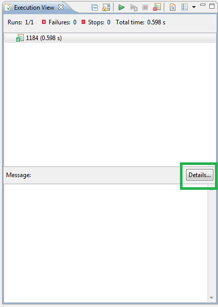

Re: Strange behaviour of text assertion [message #1445203 is a reply to message #1444741] Wed, 15 October 2014 01:40 Go to previous messageGo to next message
Could you please attach Widget Details (how to get it) and Execution Details.
