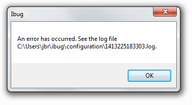

I have tried to use the compiled iBug.exe (Swing) from the Scout Demo Application
When I tried to start the exe, the application was producing error like this:
index.php/fa/19488/0/
And the mentioned log file was:

The product was valid, and no error was shown when I tried to validate it in the product editor.
The product could be started from the Eclipse IDE.
After a long search, it turns out it was a JVM problem....
What puts me on the way was this part of the "tycho-compiler:compile" documentation, more precisely useJDK property:
Default value is SYSTEM which means the currently running JDK. If BREE is specified, MANIFEST header Bundle-RequiredExecutionEnvironment is used to define the JDK to compile against. In this case, you need to provide a toolchains.xml configuration file. The value of BREE will be matched against the id of the toolchain elements in toolchains.xml.
We have this bree entry in our manifests:
Bundle-RequiredExecutionEnvironment: JavaSE-1.6
So I looked in my toolchains.xml file to check the java version that was used.
When I indicated the same version in the ibug.ini file (in the same folder than ibug.exe), the error was gone.
-vm
C:/Java/j2sdk1.6.0_37/jre/bin/javaw.exe
see also: eclipse.ini documentation.

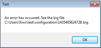

index.php/fa/22338/0/
Exhibit A: The Wondrous Error of Confusionment doth appear!

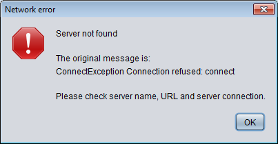

Exhibit B: Correct operation (just a normal error message because the server isn't running).
The Wondrous Error of Confusionment may already answer your summons at this point (as happened once to me during my testing of this bug). If instead you see something like Exhibit B, it's just a normal error message because the server isn't running. Do not be disheartened if the error didn't manifest - we can still coax the monster from its lair by performing the following additional steps to complicate the build a bit:
7. Select the scout project in the Scout Explorer, and then from the Scout Object Properties check 'Rayo swing Look and Feel for Eclipse Scout' to install Rayo (I have also used Docx4j to the same effect at this point). Step through the software installation wizard, agree to the terms, restart eclipse if required.
8. Repeat steps 5 and 6.
By this point you should have the error message. The error messages in the referenced log file come in several variants, depending on which plugins you have installed (see bottom of post for logs), and the clients which generate those errors can be downloaded from below that.

	at org.eclipse.core.internal.registry.ConfigurationElementHandle.createExecutableExtension(ConfigurationElementHandle.java:55)
	at org.eclipse.equinox.internal.app.EclipseAppHandle.run(EclipseAppHandle.java:191)
	at org.eclipse.core.runtime.adaptor.EclipseStarter.run(EclipseStarter.java:380)
	at org.eclipse.core.runtime.adaptor.EclipseStarter.run(EclipseStarter.java:235)
	at org.eclipse.equinox.launcher.Main.invokeFramework(Main.java:648)
	at org.eclipse.equinox.launcher.Main.basicRun(Main.java:603)
	at org.eclipse.equinox.launcher.Main.run(Main.java:1465)
Caused by: java.lang.ClassNotFoundException: test.ui.swing.SwingApplication cannot be found by org.eclipse.swt_3.103.2.v20150203-1313
	at org.eclipse.osgi.internal.loader.BundleLoader.findClassInternal(BundleLoader.java:432)
	at org.eclipse.osgi.internal.loader.BundleLoader.findClass(BundleLoader.java:345)
	at org.eclipse.osgi.internal.loader.BundleLoader.findClass(BundleLoader.java:337)
	at org.eclipse.osgi.internal.loader.ModuleClassLoader.loadClass(ModuleClassLoader.java:160)
	at org.eclipse.osgi.internal.framework.EquinoxBundle.loadClass(EquinoxBundle.java:568)
	at org.eclipse.core.internal.registry.osgi.RegistryStrategyOSGI.createExecutableExtension(RegistryStrategyOSGI.java:174)
	... 15 more
Hm, weird. The SWT plugin is trying to load the SwingApplication? When starting the Swing app? Confusing, you are.
Variant 2 (occurrs in tandem with the Rayo look & feel) :
!SESSION 2015-06-27 14:19:05.094 -----------------------------------------------
eclipse.buildId=unknown
java.version=1.7.0_21
BootLoader constants: OS=win32, ARCH=x86, WS=win32, NL=en_NZ
Command-line arguments:  -os win32 -ws win32 -arch x86
!ENTRY org.eclipse.osgi 4 0 2015-06-27 14:19:05.984
!MESSAGE Application error
!STACK 1
org.eclipse.core.runtime.CoreException: Plug-in test.client was unable to load class test.ui.swing.SwingApplication.
	at org.eclipse.core.internal.registry.osgi.RegistryStrategyOSGI.throwException(RegistryStrategyOSGI.java:194)
	at org.eclipse.core.internal.registry.osgi.RegistryStrategyOSGI.createExecutableExtension(RegistryStrategyOSGI.java:176)
	at org.eclipse.core.internal.registry.ExtensionRegistry.createExecutableExtension(ExtensionRegistry.java:905)
	at org.eclipse.core.internal.registry.ConfigurationElement.createExecutableExtension(ConfigurationElement.java:243)
Caused by: java.lang.ClassNotFoundException: test.ui.swing.SwingApplication cannot be found by test.client_1.0.0.201506271418
	... 15 more
Now the test.client plugin searches for the SwingApplication, in vain apparently.
Aaand all together now! Variant 3 (occurs in tandem with Rayo AND DocX4j at the same time) :
!SESSION 2015-06-27 14:27:35.137 -----------------------------------------------
!ENTRY org.eclipse.osgi 4 0 2015-06-27 14:27:36.166
!STACK 1
org.eclipse.core.runtime.CoreException: Plug-in org.eclipse.scout.svg.ui.swing was unable to load class test.ui.swing.SwingApplication.
Caused by: java.lang.ClassNotFoundException: test.ui.swing.SwingApplication cannot be found by org.eclipse.scout.svg.ui.swing_4.0.200.20150107-1158
	... 15 more
SVG bundle? Yeah, this is just getting silly now.
The clients can be download from my dropbox if you want to see for yourself (between 12-18MB):
testClient_working.zip
testClient_not_woring_rayo.zip
testClient_not_working_docx4j.zip
testClient_not_working_docx4j_and_rayo.zip
