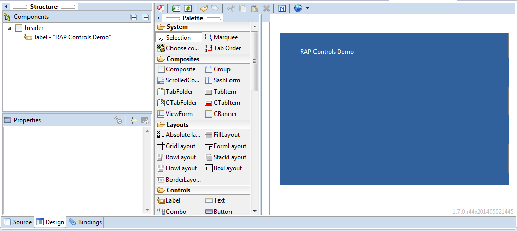

icon7.gif  SOLVED: Trouble opening EntryPoint in Windowbuilder (Eclipse luna 4.4, Windowbuilder 1.7.0) [message #1446783 is a reply to message #1444118] Fri, 17 October 2014 05:51 Go to previous messageGo to next message
Hello all,
it was hard to believe eclipse did not fix this or even marked it as won't fix or just any activity on this bug.
Finally I figured it out:
I have kept my workspace used with eclipse 4.3.2 together with the .metadata directory.
Once I deleted / renamed that .metadata and started with a brand new workspace, things started working.
The Hello World Example (RAP) did not show up in the windowbuilder because of "wrong" wrapping of composites, thus windowbuilder could not render it.
This is also a problem with the tutorial examples like the org.eclipse.rap.demo.controls example:
If you open ControlsDemo.java in windowbuilder you only see the header of the demo.
No menus, no buttons. This has got something to do with the wrapping of the composites, I think, but I don't get into it by now...
But there is some progress for me, things are starting to work out!
Greetings
P.S. attachement show ControlsDemo in windowbuilder...
