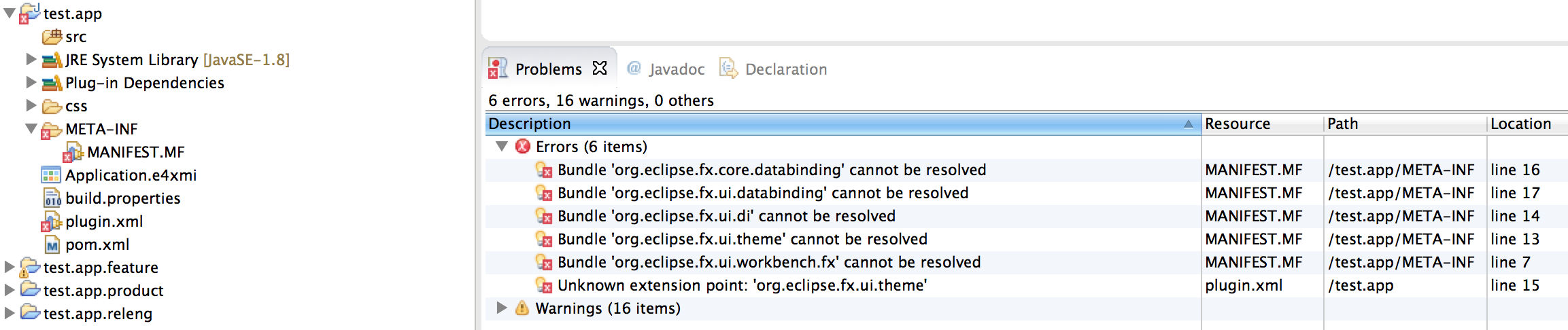

Project is successfully created however there are some errors as evidenced in the attached screenshot. Switching to the command line to invoke "mvn clean" on the .releng project (where the master pom is) results in the following exception
