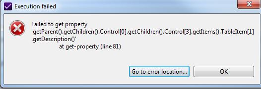

Re: How get value of first item from table? [message #1710714 is a reply to message #1441071] Thu, 08 October 2015 11:25 Go to previous messageGo to next message
HI Folks,
I have the same problem I need to select the first table element.
I try to use your snippet, it works because first table element is selected but return an error and break the execution.
index.php/fa/23486/0/
with [get-view TaskList | get-section "" | get-table] {
select ".*" | get-property "getParent().getChildren().Control[0].getChildren().Control[3].getItems().TableItem[1].getDescription()" -raw | let [val msg -input]
//Select-item $msg
global [val n [plus 1 $n]] -override
if [$n | equals 1 ]
Show-alert $msg
if I run the same code with a foreach and I can visit the table but I need to select only the first item.
I cannot use the "Record & Play" because it selected a dynamic filed value.
Re: How get value of first item from table? [message #1710718 is a reply to message #1710714] Thu, 08 October 2015 11:34 Go to previous message
Since is marked as SOLVED I open a new one.
