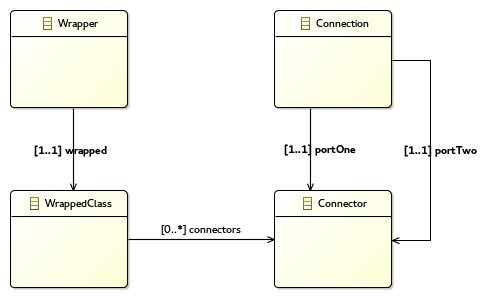

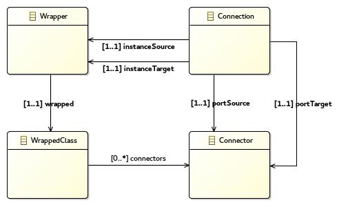

I created a diagram which should illustrate the issue:
index.php/fa/19401/0/
In this model the upper row (Wrapper and Connection) are used to assemble different WrappedClasses.
If I want to create an editor for this metamodel I want to be able to display the Connections. If I have two Wrappers with the same WrappedClasses a Connection to one of the Wrappers I cannot figure out a way to distinguish between the representations of the Connectors on both Wrappers even though they are mappings of the same instance.
  • Attachment: metamodel.jpg
    (Size: 13.99KB, Downloaded 388 times)

That works for me, too. I just recognized that the metamodel I uploaded cannot produce the situation im refering to.
This updated one should work:
index.php/fa/19416/0/
If I create the Connectors as BorderedNodes on the Wrapper, is it possible to have the Connection displayed between only the two Connectors which are on the Border of the Wrapper refered to by "instanceTarget" and "instanceSource" of the Connection?

Well I think that you can do it that way as well, but your metamodel is
more complex than the previous one. You will now have to set the new
references from Connection, that are redundant. In the previous version,
you can create an expression that navigates using an opposite reference
from connectors and wrapped.
Steve

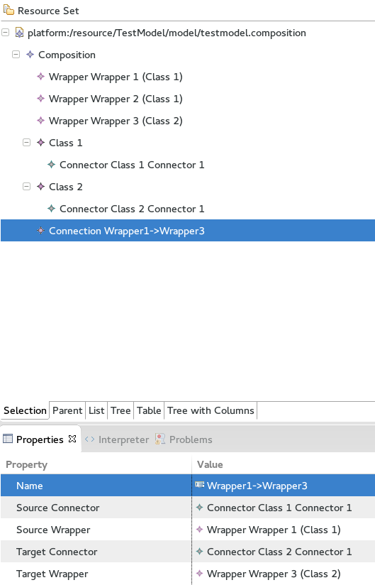

I still cant get it to work. I have created an example model:
index.php/fa/19429/0/

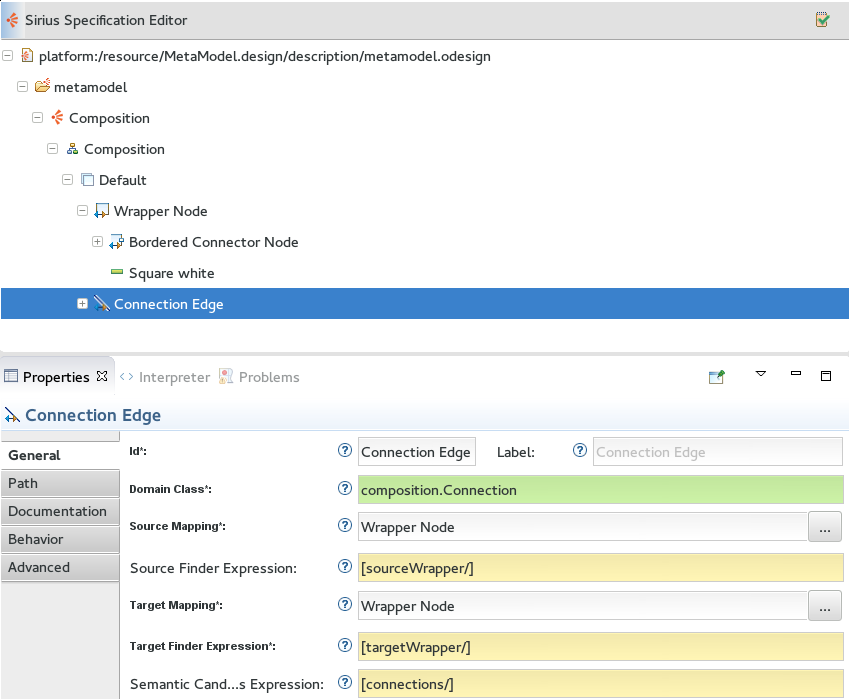

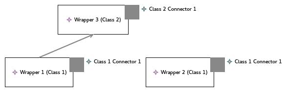

1.: Have an Element Based Edge between the two wrappers. The Edge is then displayed between the correct wrappers but I want it to be displayed to the Bordered Nodes which represent the Connectors:
index.php/fa/19430/0/
index.php/fa/19431/0/

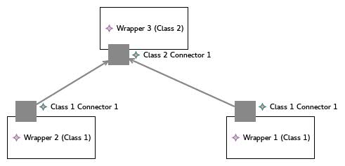

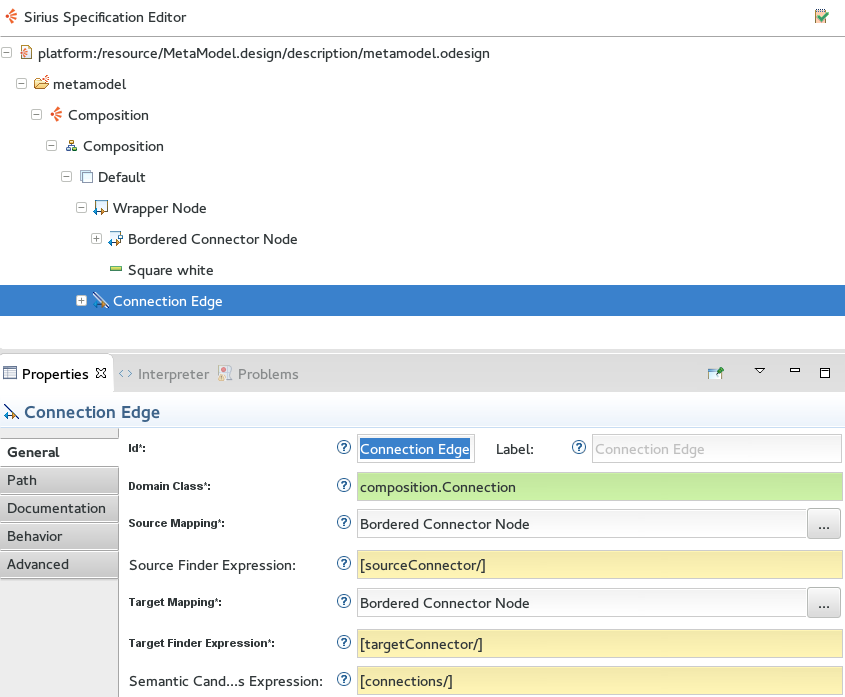

2.: If I try to create the Edge between the Bordered Nodes there is a second edge, since the ports of Wrapper 1 and 2 are the same instance. This is not intended:
index.php/fa/19432/0/
index.php/fa/19433/0/
I want to have a mix of both results, that only display the correct edge, but between the Connectors. Is this possible?

I think that even in your second solution, you need to start your
source/target finder expression using the wrapper (sourceWrapper and
targetWrapper) + the navigation to the connector. The last one must be
the one used as the semantic expression for your border node. So it
would be something like source finder expression
[sourceWrapper.connector/] and target finder expression
[targetWrapper.connector/].
