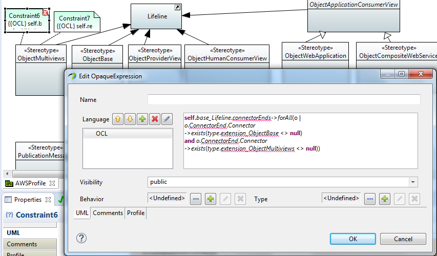

Re: Need help for OCL Syntax [message #1434574 is a reply to message #1434450] Tue, 30 September 2014 05:15 Go to previous messageGo to next message
I used Papyrus v 1.0.0 20140611 build and OCL Classic SDK: Ecore/UML Parsers,Evaluator,Edit 5.0.2.v20140819-1612.
I put the constraint that you proposed in the OCL editor:
self.base_Lifeline.connectorEnds->forAll(o |
o.ConnectorEnd.Connector
->exists(type.extension_ObjectBase <> null)
and o.ConnectorEnd.Connector
->exists(type.extension_ObjectMultiviews <> null))
But the parser didn't accept it...
I don't know why?
I put some screenshots
  • Attachment: error1.png
    (Size: 71.68KB, Downloaded 196 times)
  • Attachment: error2.png
    (Size: 80.98KB, Downloaded 238 times)
Re: Need help for OCL Syntax [message #1434841 is a reply to message #1434574] Tue, 30 September 2014 13:26 Go to previous messageGo to next message
Red squiggles denote errors which need fixing.
o.ConnectorEnd looks smelly but ...
http://wiki.eclipse.org/OCL/ForumNetiquette
Ed Willink
