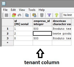

Hi guys!
I'm developing a multitenancy system and I'm using Single-Table Multi-Tenancy.
So when I persist a new multitenancy object the column that reference the tenant column is saved in blank and I don't know why.
I did a test but it worked well...

when I execute a test class the object is saved correctly with the tenant_id 500... but when the applications is running this not occur... and I'm using a similar code to do this....
I'm using JSF, Spring Framework, and PostgreSQL the tenant identifier is in session and when I need I build a EntityManager like above with tenant identifier

so... what I do? what is it? why this is happening?
follows the image of the database after the operations
  • Attachment: table.jpg
    (Size: 29.48KB, Downloaded 160 times)
