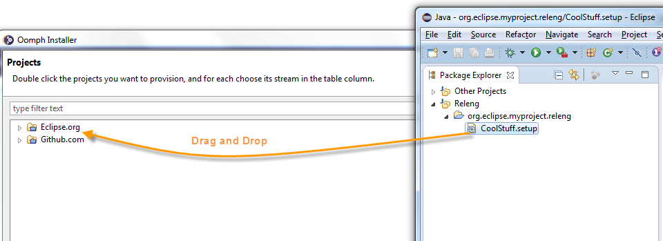

Re: How to create a new Setup [message #1494735 is a reply to message #1426954] Mon, 01 December 2014 13:17 Go to previous messageGo to next message
Your as written on this blog A quick update for future readers by Stefan Winkler:
The new version of Oomph (which is now a separate Eclipse project) does not require copying models into the setup/Oomph folder anymore. Instead, after starting setup-eclipse, you can just drag and drop a user-created model into the projects tree after you have selected the Eclipse package.
And by Drag an Drop you need to really hit one of the folder (it will not work if you drop in the empty space)
index.php/fa/20087/0/
I took the liberty to mention this thread on the wiki page.
By the way: thank you a lot for this nice tool and all your work on it.
  • Attachment: DnD_setup.png
    (Size: 45.65KB, Downloaded 2916 times)
[Updated on: Mon, 01 December 2014 13:18] by Moderator
Re: How to create a new Setup [message #1494755 is a reply to message #1494735] Mon, 01 December 2014 13:37 Go to previous messageGo to next message
Am 01.12.2014 um 19:17 schrieb Jeremie Bresson:
> Your as written on this blog http://www.winklerweb.net/index.php/blog/12-eclipse/20-creating-custom-installations-with-oomph#comment-69 Stefan Winkler:
> Quote:
Of course any help with wiki is highly appreciated.
Where exactly did you add that detail? I couldn't find it. I thought this could be a good place:
https://wiki.eclipse.org/Eclipse_Oomph_FAQ#How_can_I_add_my_own_setup_files.3F
BTW. we were talking about another new way to add own project (or even product) setups. That would be via the green plus
button on the two catalog pages. Currently they only support adding existing setup files, but in theory they could also
create (and link in) new, empty models and provision and IDE to start authoring them.

Re: How to create a new Setup [message #1495548 is a reply to message #1494755] Tue, 02 December 2014 04:51 Go to previous messageGo to next message
Thanks for your quick answer.
I think the green plus would be a nice way. I have tried to click on it.
(have you a change request bug for this?)
The wiki page I have changed is the one mentioned by Aurelien in its first post:
https://wiki.eclipse.org/Eclipse_Oomph_Authoring (diff)
I will try to update the FAQ page and the Authoring page (probabelly when the change request is made => metionning the green "+" is easier than describing a drag and drop area).
