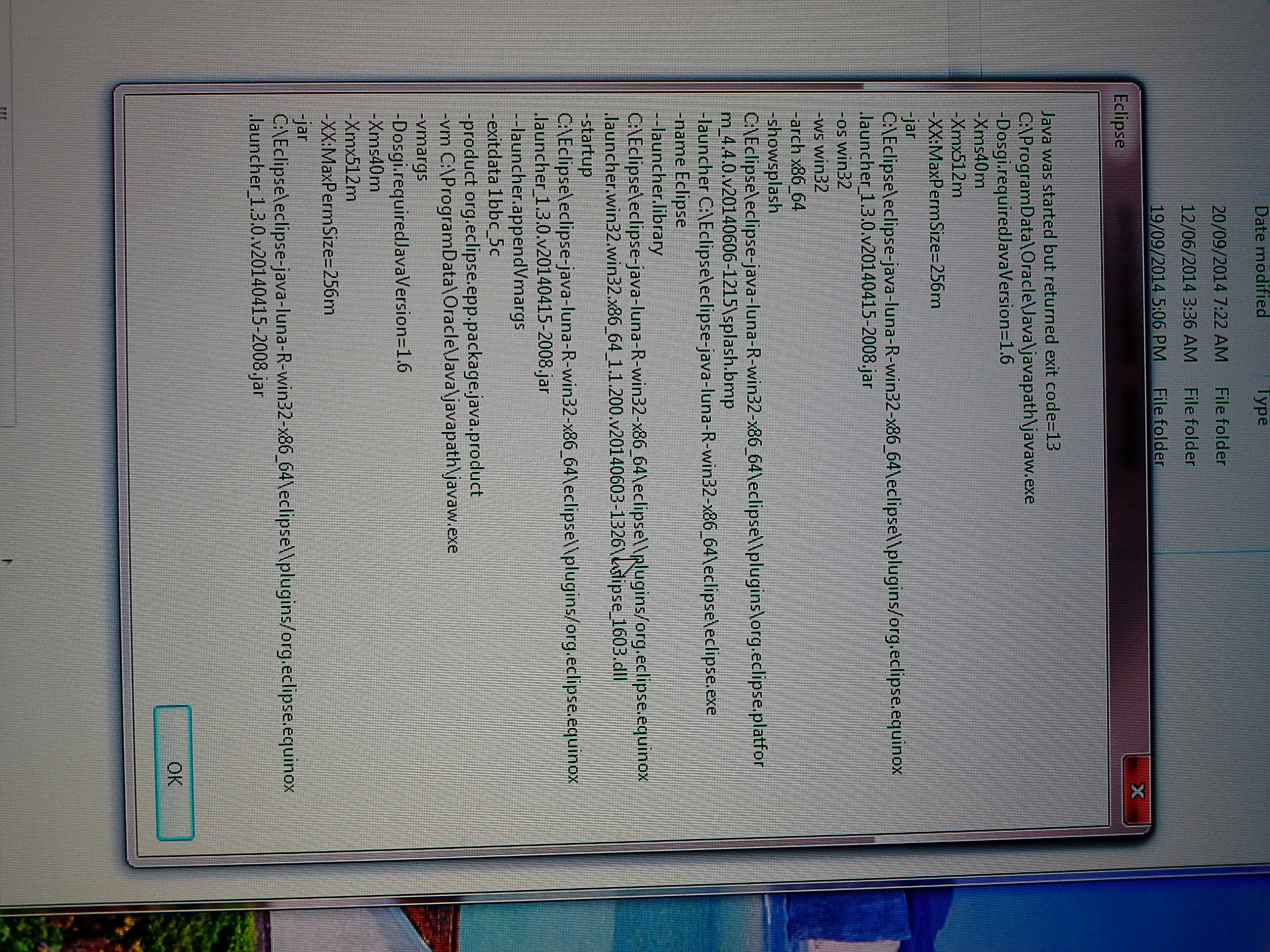

Re: Getting Eclipse to run [message #1426475 is a reply to message #1426014] Thu, 18 September 2014 16:28 Go to previous messageGo to next message
Thanks for the prompt reply. It appears to be related to the eclipse.ini file. An error 13 comes up with a lot of text from that file. I have attached a screen shot
Thanks again

Re: Getting Eclipse to run [message #1427084 is a reply to message #1426475] Fri, 19 September 2014 13:25 Go to previous messageGo to next message
Don't use MS word to post screen shots; upload them as standard images (png, jpeg, etc) if you want the most people to help.
Re: Getting Eclipse to run [message #1427197 is a reply to message #1427084] Fri, 19 September 2014 17:38 Go to previous messageGo to next message
Thanks for the advice. I have attached a jpeg image of the error that is generated when I try to run eclipse. As I said in a previous response it appears to be related with the contents in the eclipse.ini file.

Re: Getting Eclipse to run [message #1427414 is a reply to message #1427197] Sat, 20 September 2014 02:01 Go to previous messageGo to next message
Not sure why it's in ProgramData, but the most frequent cause of error 13 is a 32/64-bit mismatch between the installed Java and downloaded Eclipse. You can check whether it's actually a 64-bit Java by running its java.exe, from a Command Prompt window, with the -d64 argument, e.g. java.exe -d64
Re: Getting Eclipse to run [message #1428480 is a reply to message #1427414] Sun, 21 September 2014 19:14 Go to previous message
Thanks for the prompt reply. You are correct it was a 32/64 bit mismatch. Once I downloaded the correct 64 bit software I am off and running.
