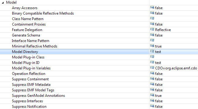

Here my GenModel configuration :
index.php/fa/19143/0/

The default EList implementation for containment references, used here, does not resolve proxies. This is because cross-resource containment support must be explicitly enabled for a model. This is done from within the EMF
generator, via a property on the root - level GenModel object. [9]The value of the "Containment Proxies" property determines whether any containment references in the model can be proxy resolving. If it is true, then any
EReference in the model for which resolveProxies is true will support cross-resource containment
I assume that i have to split my resource in CDO to optimize the loading.
