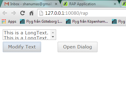

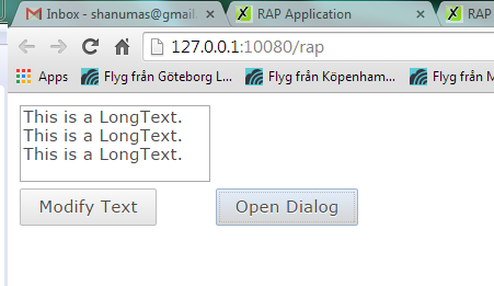

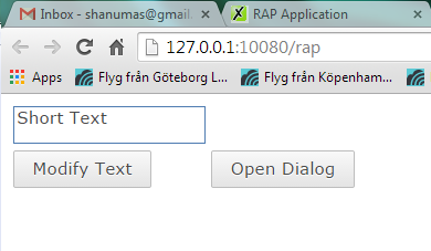

I have attached a Sample View(called TextView).
Step 1: The view is loaded with a textBox(SWT.Wrap) with a simple text.
Step 2: Click "Modify Text" . Then a Long text is set to the textBox. Since the text is too long, it wraps.
Step 3: Click "Open Dialog". When the dialog is opened, the text box expands and becomes greedy. It occupies as much space as needed. This is the problem.
When I debug the code, the change in the UI(pack) happend just after the lock.wait() call in the switchThread() method of UIThread class (During dialog.open() method call). Is that a good clue?
