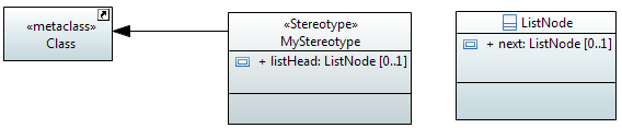

Scenario:
  • Create a profile.
  • Create one stereotype with a property linkHead, typed by a profile defined class LinkNode. This linkHead is the start of the archetypal LinkedList, built by chaining objects of type LinkNode. Although not being a practically useful example, it clearly shows the issue (see below).
  • You obtain something like
    index.php/fa/19077/0/
  • Create a model and apply the defined profile.

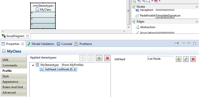

  • Create a LinkNode using the + in the right-hand side of the properties editor.
  • You obtain a screen like:
    index.php/fa/19078/0/
Problem:
It seems impossible to edit the properties of the profile defined class "LinkNode".
In this example, it means you can't create "next" LinkNodes.
Also (to be expected) the model explorer doesn't seem to provide any workaround for this case.

Re: Setting values for stereotype properties typed by profile defined classes [message #1419441 is a reply to message #1419406] Mon, 08 September 2014 12:18 Go to previous messageGo to next message
Your use case works for me when I define ListNode in the profile as a
DataType, not a Class. If I recall correctly, Papyrus does not support
the instantiation of profile-defined classes, only data types, which
should work pretty much exactly as you would expect your class to work.
