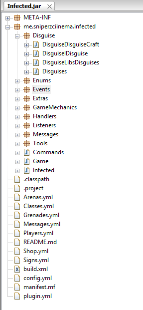

I don't know how to make packages in packages like show in the picture. Help! It's the only thing I need help with!

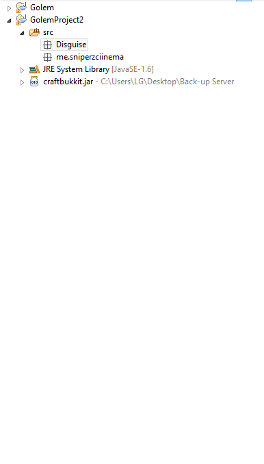

Doesn't work. See?

Now create a new class (.java) underneath and you'll the icon change to
a colored one.

I see. So when you ask Eclipse to draw you a dog, it draws you a dog,
but you don't like the dog so you say it didn't draw you a dog?
What you illustrated in your first post wasn't an Eclipse project in the
Package or Project Explorer view. In fact, I don't even know what it's a
picture of. The second post was an Eclipse project with packages exactly
as expected. It's a different thing, but it's working fine.

There is no such thing as a child package in Java. Each package is
separate. If you want to show packages in a hierarchical way, you can
use the menu for the Package Explorer view to set the Package
Presentation to Hierarchical. The Package Explorer menu is activated by
clicking on the downward pointing triangle on the right hand side of the
Package Explorer view tab.
