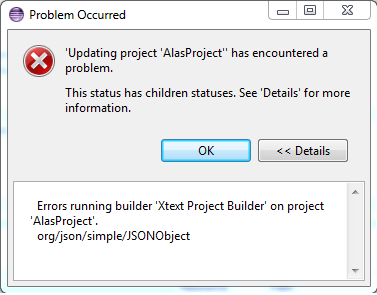

Re: Xtext imports [message #1421630 is a reply to message #1420903] Thu, 11 September 2014 12:49 Go to previous messageGo to next message
Thank you Christian and Sebastian, I tried your solution and it works for me too but only with java class. When I try with some my class it doesn't work
members += entity.toMethod("onMessage", entity.newTypeRef(void)) [
documentation = entity.documentation
parameters += entity.toParameter("msg", newTypeRef("xjaf.server.msm.fipa.acl.ACLMessage"))
body = [append('''
if(msg.getPerformative() == «entity.newTypeRef("xjaf.server.msm.fipa.acl.Performative")».REQUEST){
String s = msg.getContent().toString();
«entity.newTypeRef("org.json.simple.parser.JSONParser")» parser = new JSONParser();
«entity.newTypeRef("org.json.simple.JSONObject")» json;
from this code I get:
public void onMessage(final xjaf.server.msm.fipa.acl.ACLMessage msg) {
if(msg.getPerformative() == JvmParameterizedTypeReference: xjaf.server.msm.fipa.acl.Performative.REQUEST){
JvmParameterizedTypeReference: org.json.simple.parser.JSONParser parser = new JSONParser();
JvmParameterizedTypeReference: org.json.simple.JSONObject json;
Is there any solution for non java class?
Thank you in advace,
Marko
Re: Xtext imports [message #1421654 is a reply to message #1421630] Thu, 11 September 2014 13:39 Go to previous messageGo to next message
hi
that does this make a "non java class"???? is xjaf.server.msm.fipa.acl.Performative inferred from the entity?

I already have that classes in .alas file.
If I write
«entity.newTypeRef(org.json.simple.JSONObject)»
and when I create my .alas file I get error.png from attach
for next code
I get java code:
JvmParameterizedTypeReference: org.json.simple.JSONObject;
Marko

Re: Xtext imports [message #1421971 is a reply to message #1421815] Fri, 12 September 2014 02:01 Go to previous messageGo to next message
Hi can you show a screenshot of the project/classpath as well
