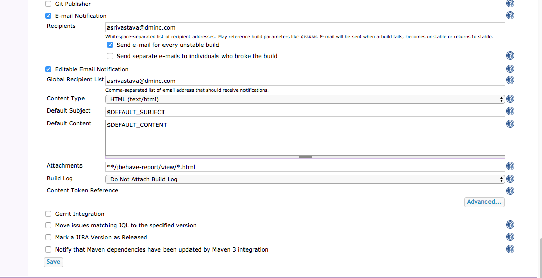

You could use email-ext plugin. We generate HTML and e-mail it as shown in the screenshot
https://dl.dropboxusercontent.com/u/13144273/email-ext-sample.png

Re: Email jBehave reports or workspace artifacts as attachments [message #1767373 is a reply to message #1766372] Wed, 05 July 2017 07:11 Go to previous message
Kindly refer for below attachment for emailing results to someone.
