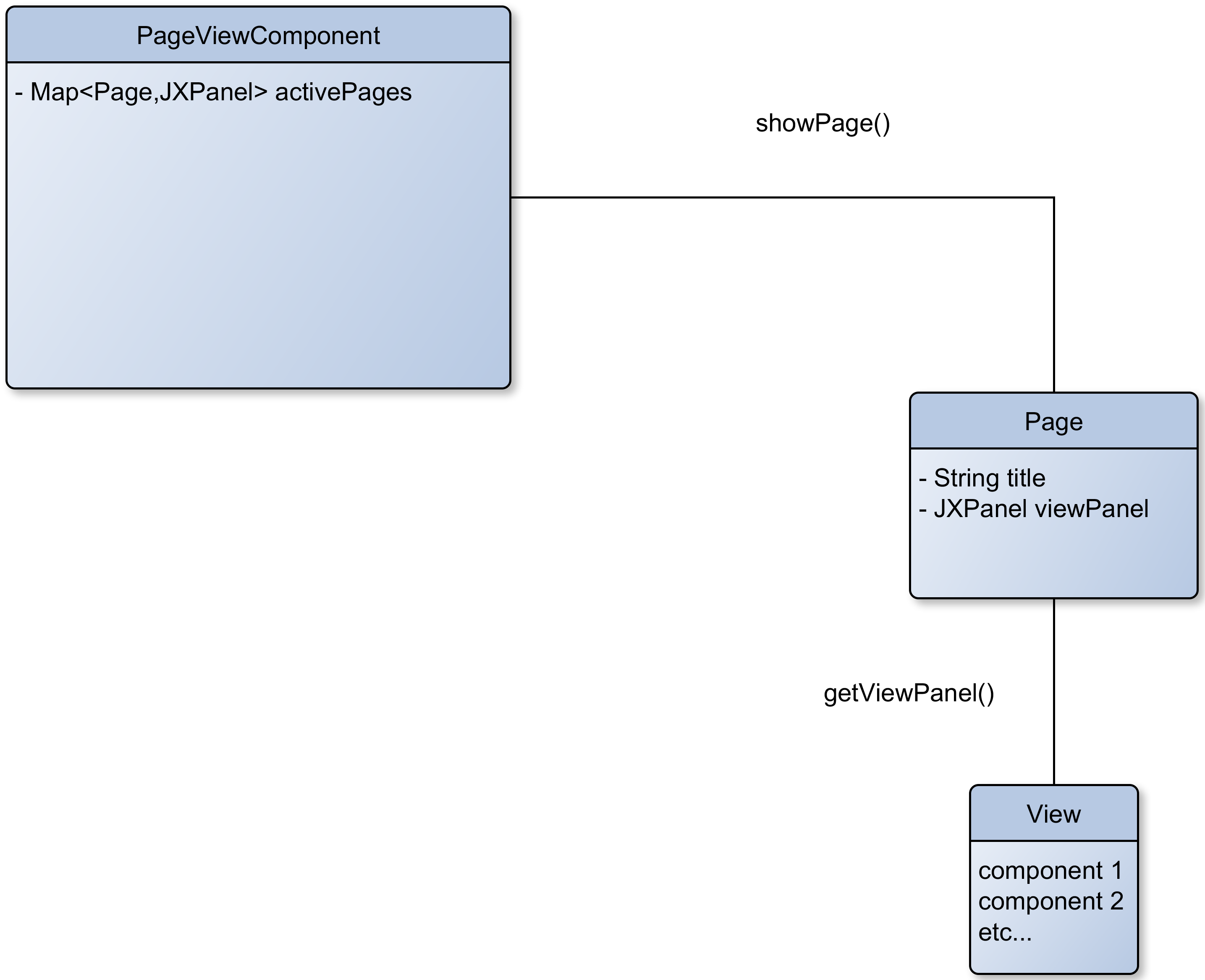

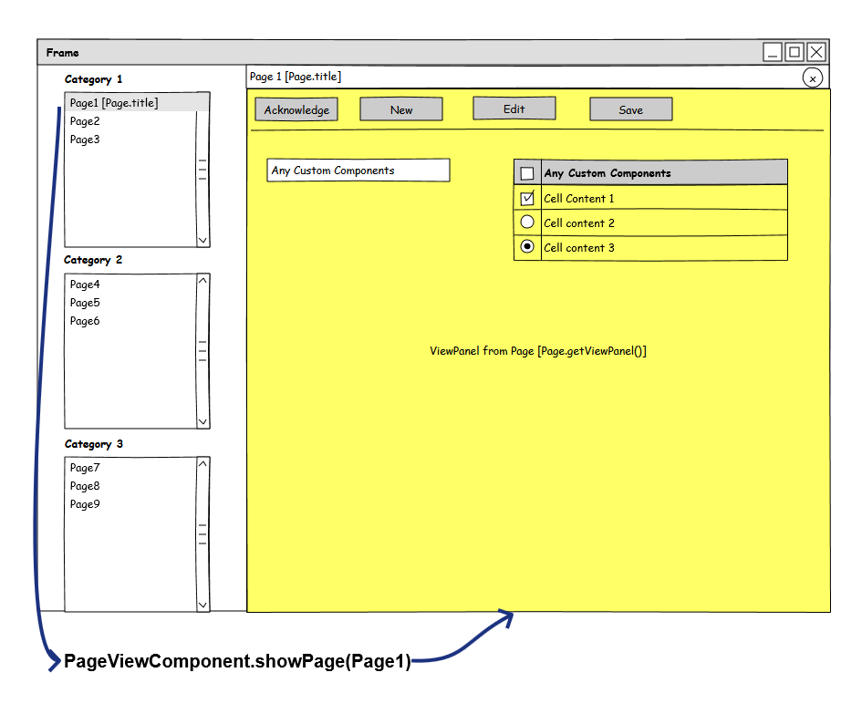

Secondly we generate the production of our GUI by the usage of Spring features such as the Autowired function and by our own implementation. Therefore I made a mockup and small class diagram to demonstrate the structure of our GUI. Having a look at image "MockupMainFrame" you can see that we have a frame which contains a list of pages on the left hand side and a open and active page on the right hand side. The Page is a JXTitledPanel with a close Button as the "Right decoration" and the Page title as the title of the Panel. Inside the Panel (highlighted yellow) we have all our components contained in another panel. Each page contains the same toolbar (the buttons on top, "Acknowledge", "New", "Edit", "Save"...) and any custom components which differentiate each page. By regarding image "UML1" you can see that with our PageViewComponent we enable and disable our visibility of a Page via the showPage()-method.
index.php/fa/18944/0/

public class PageViewComponent extends JXTitledPanel{
	private final Map<Page, Container> activePages = Maps.newHashMap();
	private Page activePage;
	public void showPage(Page page) {
		setTitle(page.getName());
		JPanel content = new JPanel(new MigLayout("fill", "[fill]", "[fill]"));
		content.add(activePages.get(page));
		content.add(toolbar.getComponent(), "dock north");
		setContentContainer(content);
		setRightDecoration(closeButton);
		activePage = page;
		activePage.getPropertyChangeSupport().addPropertyChangeListener(this);
		activePage.getPropertyChangeSupport().firePropertyChange("visible", false, true);
Every time a button on the left hand side gets clicked, an action invokes the method "showpage()" and shows the actual active page. The visibility of the old pages will be disabled. With this setup we are able to object map the title of the JXTitledPanel and the Right Decoration (in this case the closedButton), everything what is highlighted yellow in image "MockupMainFrame" however can't be mapped even though we get a green rectangle around every swing component.
