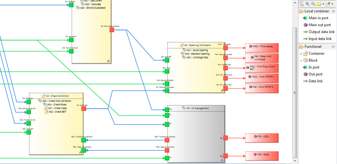

My editor manages blocks, containers which can contains blocks, links and port (I attach a screenshot of an editor.)
My application is in E4 with the 3.x compatibility layer. But for the Sirius editor I don't know if it uses E4 version.
Thanks.
