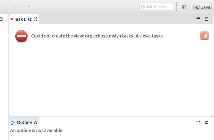

icon9.gif  I have installed the most recent e(fx)clipse AinO packages and it gives me this errors [message #1410778] Thu, 21 August 2014 11:37 Go to next message
!SESSION 2014-08-21 14:48:27.460 -----------------------------------------------
eclipse.buildId=4.4.0.I20140606-1215
java.version=1.8.0_20
BootLoader constants: OS=linux, ARCH=x86_64, WS=gtk, NL=ko_KR
Command-line arguments:  -os linux -ws gtk -arch x86_64
!ENTRY org.eclipse.fx.ide.java6 4 0 2014-08-21 14:48:39.440
!MESSAGE FrameworkEvent ERROR
!STACK 0
org.osgi.framework.BundleException: Could not resolve module: org.eclipse.fx.ide.java6 [218]
  Unresolved requirement: Require-Capability: osgi.ee; filter:="(&(osgi.ee=JavaSE)(version>=1.3)(!(version>=1.8)))"
	at org.eclipse.osgi.container.Module.start(Module.java:434)
	at org.eclipse.osgi.container.ModuleContainer$ContainerStartLevel.incStartLevel(ModuleContainer.java:1582)
	at org.eclipse.osgi.container.ModuleContainer$ContainerStartLevel.incStartLevel(ModuleContainer.java:1561)
	at org.eclipse.osgi.container.ModuleContainer$ContainerStartLevel.doContainerStartLevel(ModuleContainer.java:1533)
	at org.eclipse.osgi.container.ModuleContainer$ContainerStartLevel.dispatchEvent(ModuleContainer.java:1476)
	at org.eclipse.osgi.container.ModuleContainer$ContainerStartLevel.dispatchEvent(ModuleContainer.java:1)
	at org.eclipse.osgi.framework.eventmgr.EventManager.dispatchEvent(EventManager.java:230)
	at org.eclipse.osgi.framework.eventmgr.EventManager$EventThread.run(EventManager.java:340)
!ENTRY org.eclipse.e4.ui.workbench 1 0 2014-08-21 14:48:59.044
!MESSAGE Nothing to merge for "platform:/plugin/org.eclipse.e4.tools.emf.ui/fragment.e4xmi"
!ENTRY org.eclipse.e4.ui.workbench 1 0 2014-08-21 14:48:59.050
What should I do? Sad

Re: I have installed the most recent e(fx)clipse AinO packages and it gives me this errors [message #1410781 is a reply to message #1410778] Thu, 21 August 2014 11:42 Go to previous messageGo to next message
Is something not working?
The resolve error is expected and *has to* happen because we only want
the "org.eclipse.fx.ide.java6" to resolve if you happen to run on JDK7
or even JDK6.
Tom

The task list window is not working Sad
By the way, I am using oracle java 1.8.0.20(verified with java -version) and Ubuntu 64bit.
  • Attachment: error.jpg
    (Size: 29.69KB, Downloaded 9902 times)
Re: I have installed the most recent e(fx)clipse AinO packages and it gives me this errors [message #1410848 is a reply to message #1410791] Thu, 21 August 2014 15:44 Go to previous messageGo to next message
Well you don't have Mylyn installed so there's no suprise it does not
open. You need to post install Mylyn into the All-In-One-Download.
Tom

Re: I have installed the most recent e(fx)clipse AinO packages and it gives me this errors [message #1410953 is a reply to message #1410848] Thu, 21 August 2014 23:15 Go to previous messageGo to next message
Oh, thanks, I installed Mylyn. and It works now Smile
I think unother error comes from missing emf tool, I'll try to install that as well.
