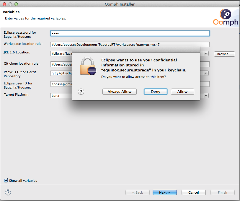

When performing startup tasks (automatically) Oomph pops up a dialog asking for permission to access secure information from my keychain (I'm on MacOSX 10.9), in particular it asks me for my Bugzilla password (which I have previously entered), but it pops up the dialog 8 times for every single character that I type. (See screenshot attached). It does this every time I start Eclipse, making it unbearable. Why is it doing this? And more importantly, how can I prevent it from doing that?
Which of the three choices do you do with the dialog that comes up?

Re: Eclipse unusable after latest Oomph update [message #1408229 is a reply to message #1407875] Thu, 14 August 2014 10:51 Go to previous messageGo to next message
I've tried the three choices. Only when I click on "Deny" it will stop asking.
I found out that on Preferences > General > Security > Secure Storage there are entries for "Master password providers", but even if I uncheck them, I still get Oomph to ask for such access. (I'm attaching the screenshot).

Re: Eclipse unusable after latest Oomph update [message #1408252 is a reply to message #1408248] Thu, 14 August 2014 11:48 Go to previous messageGo to next message
They were originally checked. I found a post elsewhere (https://www.eclipse.org/forums/index.php/t/235447/#page_top) suggesting the problem with not accepting passwords was this and that trying to uncheck them would work. But alas, it doesn't.
Also, the [Deny] button doesn't actually stop the repetition as I mentioned before.
I tried updating Oomph, and then it failed to start altogether. Now I'm trying to redo everything from a clean slate, downloading Oomph again, removing ~/.eclipse and ~/.p2 to see if that will lead an environment in a good working state.
