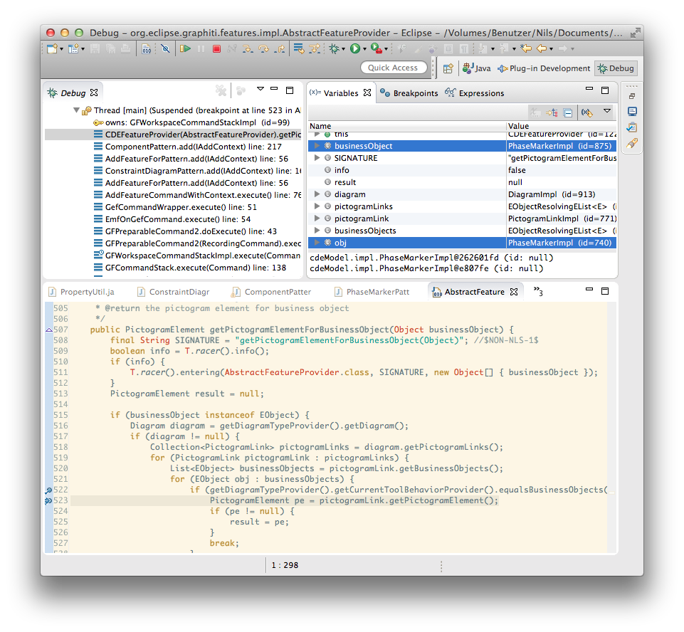

I have two separate business objects of the same class. Now I want to get the pictogram elements for each of these. But the getPictogramElementForBusinessObject(Object businessObject) method returns the same pictogram element for both business objects.
When I look at the XML code my diagram file, I can see clearly that the links of the pictogram elements point to different business objects. So my code that's setting up the links is fine.
I went into the debugger and stepped through the methods and looked around the call stack.
Attached is a screenshot of the situation where the if statement just got evaluated to true for one of the business objects. In the Variables tab on the upper right one can see that the variables businessObject and obj actually contain different objects of the same class. So why did this evaluate to true for this businessObject, when it shouldn't?
I stepped deeper into it and EcoreUtils' equals method sets up an EqualityHelper and calls it's own equals method with the two given objects. It seems to me, that it just looks at the type of the class.
Can anybody help or clear up the situation?

The method DefaultToolBehaviorProvider#equalsBusinessObjects(...) uses EcoreUtil#equals(...) which does NOT check for object identity. Instead it compares the EClasses of the objects and the values of their properties. If these are the same, two objects are considered equal.
Martin

But right, the JavaDoc of getPictogramElementForBusinessObject should
mention that, I'll add it there.
