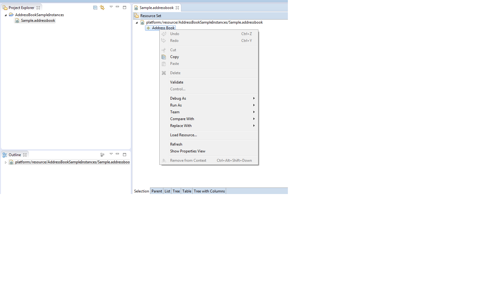

Hi I'm learning how to use the Eclipse Modeling Framework using this tutorial www .vogella.com/tutorials/EclipseEMF/article.html.
However i have a problem when i get to the part 5.4, when i right on "My Web" I don't have the option to create a new child(I don't have the same ecore model but it should work anyway):
index.php/fa/18751/0/
I also couldn't create an "Ecore Diagram" earlier in the tutorial just an "Ecore Model", the only difference being i couldn't create my model with drag and drop, maybe this has to do with my main problem.
  • Attachment: Instances.png
    (Size: 36.32KB, Downloaded 369 times)

Most likely that's because AddressBook doesn't have any containment
references.
