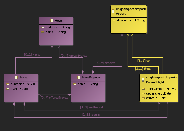

I'm trying to create an editor that is able to manage export/import-interfaces between ecore-models. For reasons of backwards compability I cannot just use a DSL to specify exported/imported-elements but have to use standard ecore-models and do the exporting/importing of their elements in seperate files. The editor then reads the files and displays a model accordingly.
The following rules apply:
-everything from the ecore-specification is exportable/importable
-a model can export any number of elements to any number of export interfaces
-a model can import any number of import interfaces
-any number of import-interfaces can reference one export interface
-one element of an import interface must reference exactly one element of an export interface

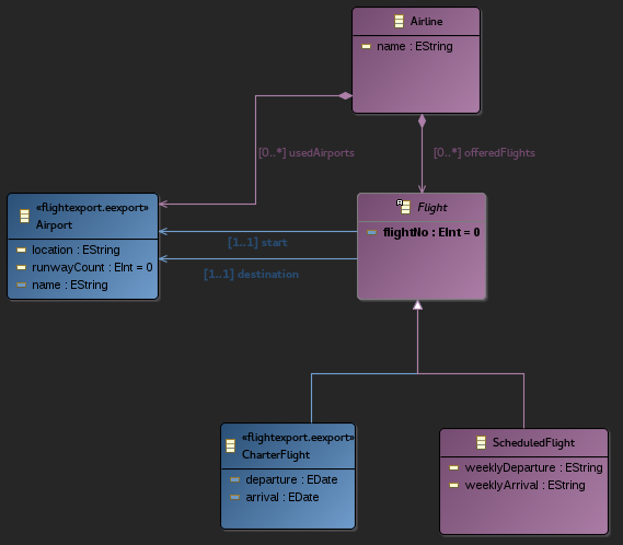

So far I've managed to display which elements are imported (yellow), exported (blue) or native (purple) to the model (see images).
As you see in the example I export the classes CharterFlight (all attributes) and Airport (only the name-attribute) and the attribute FlightNo from the airport-model.
I import them into the travelagency-model as the classes Airport (description corresponds to name) and BookedFlight (attributes from CharterFlight + FlightNo).

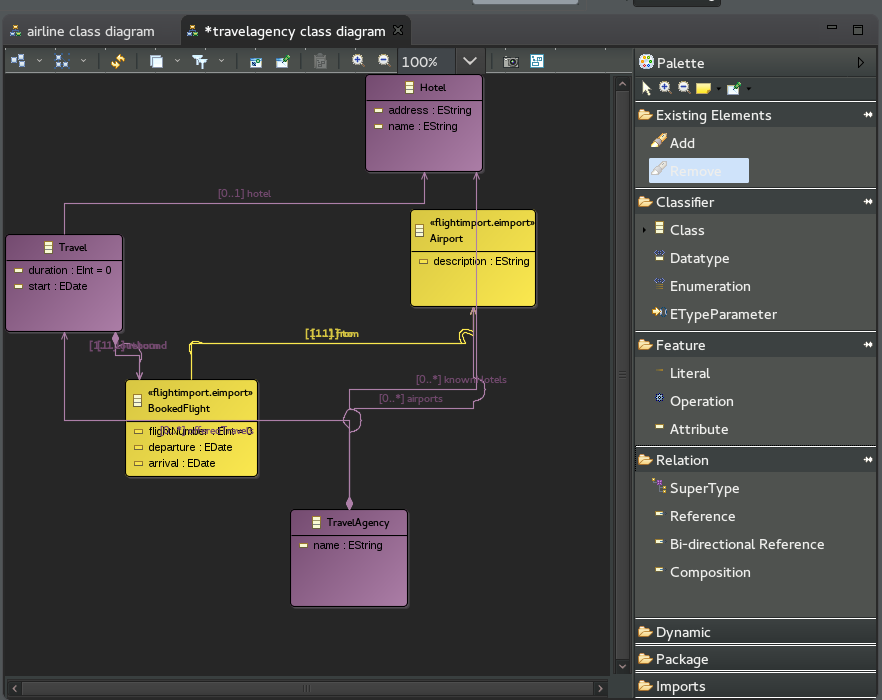

The idea was to use the elements in the palette as an easy way to link an element in the model to an element in the interface. Basically creating (for example) a new class in your model but already link it to the corresponding interface element.
Without the dynamic modification of the palette the user has to create a new class and manually link it to an interface element. I've added a screenshot including the palette as it is of now. Maybe that helps for clarification.
You answered my question though. Sadly I can't do such a thing statically, because the interfaces vary from model to model and are also created dynamically.
