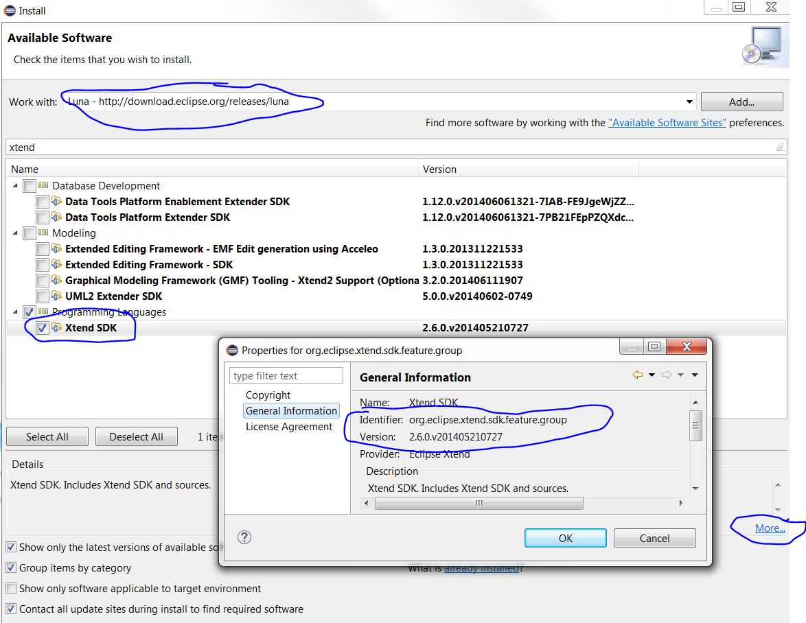

Attached is how to capture all the details, i.e., figure out which
update side you want to work with, find the feature you're
interested in, select it, click the "More..." button, and in the
"General Information section, you see the identifier and the
version.   The "Work with" must be listed in the p2 task's
repositories and the Identifier  must be listed in the p2 task's
requirement; you don't have to specify a version range, because the
omni range is the default, but you can specify one if you want to
restrict your installation to a particular version of Xtend (because
you might end up with version 2.7 if some other p2 task lists a repo
that contains a higher version number).<br>
<br>
<img src="https://www.eclipse.org/forums/index.php?t=getfile&amp;id=18771" alt=""><br>

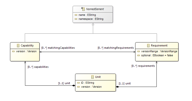

First you should understand some of p2's core concepts:<br>
<br>
<img src="https://www.eclipse.org/forums/index.php?t=getfile&amp;id=18785" alt=""><br>
Installable units (IUs) provide capabilities that are identified by
namespace+name+version. IUs express their own requirements against
the *capabilities* of other IUs by specifying namespace+name+version
*range* (and a couple more properties such as cardinality or match
expressions).<br>
<br>
All IUs are supposed to provide kind of a "self" capability, i.e., a
capability with namespace == "org.eclipse.equinox.p2.iu", name ==
IU.id and version == IU.version. That's why you use that namespace
when you want to require another IU.<br>

<blockquote cite="mid:lrqq9q$lio$1@xxxxxxxxe.org" type="cite">
When I tried installing Xtend using the Luna update site
(<a class="moz-txt-link-freetext" href="http://download.eclipse.org/releases/luna">http://download.eclipse.org/releases/luna</a>) it installed some
xtend/xtext plugins but it didn't show </blockquote>
Where did you look?<br>
<br>
<blockquote cite="mid:lrqq9q$lio$1@xxxxxxxxe.org" type="cite">any
feature (even though I provided
org.eclipse.xtend.sdk.feature.group as ID, like you said).
Furthermore, there were no UI contributions (there should be at
least "New...&gt;Xtend Class". However, when I used the TMF update
site
(<a class="moz-txt-link-freetext" href="http://download.eclipse.org/modeling/tmf/xtext/updates/composite/releases/">http://download.eclipse.org/modeling/tmf/xtext/updates/composite/releases/</a>)
it did install the feature and UI contributions. So it sounds to
me that there is some disparity between what is provided by the
two sites, </blockquote>
That's possible in principle and AFAIK common practice at Eclipse. I
don't know that feature; maybe you want to clarify that in the Xtext
forum.<br>
<br>
<blockquote cite="mid:lrqq9q$lio$1@xxxxxxxxe.org" type="cite">but
in any case, if I specified a feature group as requirement,
shouldn't here be a feature visible under "Installation Details"?
<br>
</blockquote>
Yes, it should. Can you please post your Oomph setup.log and a
screenshot of your Installation Details dialog?<br>
<br>
Cheers<br>
/Eike<br>

[quote title=Eike Stepper wrote on Tue, 05 August 2014 12:27]<html>
I looked under About Eclipse > Installation Details > Installed Software and Features
<br>
site
forum.<br>
I have. No response yet.
<br>
</blockquote>
I'm trying to reproduce this, but this time, starting from scratch I even get the Xtend SDK. Is that because I had added to user.setup?
To be sure I tried removing temporarily the ~/.p2 and ~./eclipse folders and starting again from real scratch, but this time Oomph failed during the bootstrap. I'm attaching the beginning of the first exception I got in the Oomph console messages (the full file of messages is 8.7MB which I cannot upload) and the log file.
