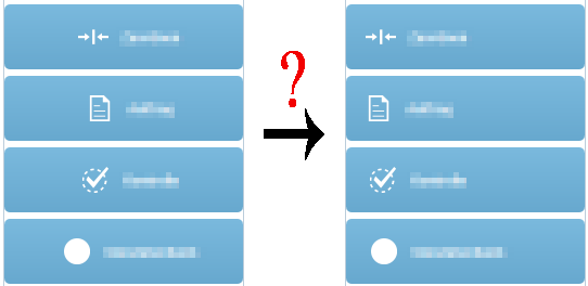

how to align the content of a button (image + text) to a distinct direction e. g. left side. The property 'label position' seem not to work. I does not matter which value I use, the content is always centered. The button is inside a GroupBox and the property 'Fill Horizontal' is true.
In the attached image yout can see how I want to align the content.

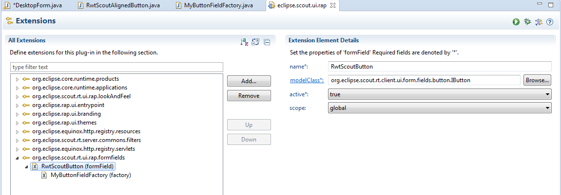

3) Now, open the plugin.xml in the <your project>.ui.rap bundle, click on "Add..." and add a new 'org.eclipse.scout.rt.ui.rap.formfields' extension. Create a new formField, and set the modelClass to 'org.eclipse.scout.rt.client.ui.form.fields.button.IButton', 'active' to 'true' and 'scope' to 'global'.
index.php/fa/18739/0/

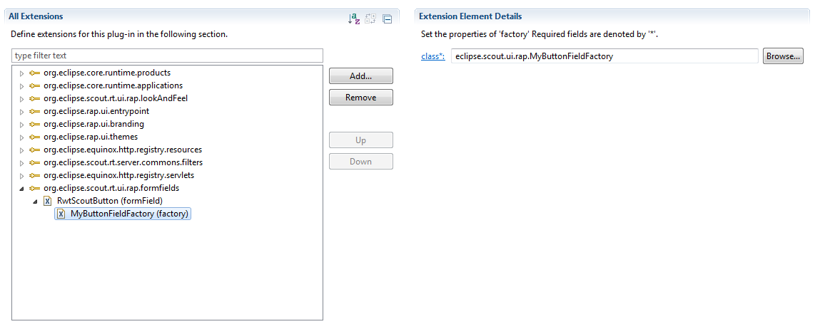

4) Create a new uiFactory below the new entry, which references your MyButtonFieldFactory
index.php/fa/18740/0/

As you can see, you can now change the default alignment. But notice, this solution only applies to RAP in the moment. SWT and Swing will still align the button centered, however you can use the same strategy to change the alignment. However If you really need this feature I would recommend to create a change request.
index.php/fa/18741/0/
