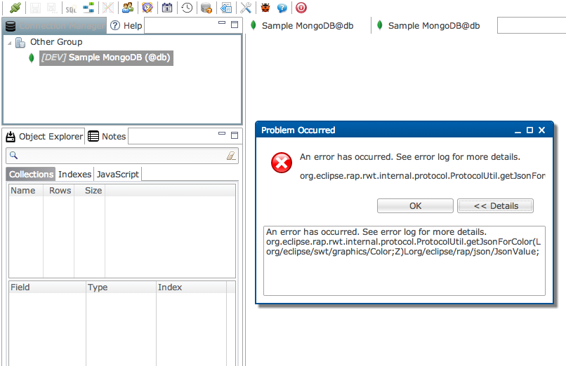

Sometime raising exception. [message #1404292] Wed, 30 July 2014 21:10 Go to next message
What to do?
os : Mac
browser : Chrome 36
An error has occurred. See error log for more details.
org.eclipse.rap.rwt.internal.protocol.ProtocolUtil.getJsonForColor(Lorg/eclipse/swt/graphics/Color;Z)Lorg/eclipse/rap/json/JsonValue;
Thanks.

Re: Sometime raising exception. [message #1404304 is a reply to message #1404292] Thu, 31 July 2014 03:00 Go to previous messageGo to next message
which RAP version are you using? Please provide the exception complete
stack trace.

Re: Sometime raising exception. [message #1404306 is a reply to message #1404304] Thu, 31 July 2014 03:18 Go to previous messageGo to next message
thanks replayed.
I using RAP version is rap-2.3.0-R-20140610-0925.
exception trace..

java.lang.NoSuchMethodError: org.eclipse.rap.rwt.internal.protocol.ProtocolUtil.getJsonForColor(Lorg/eclipse/swt/graphics/Color;Z)Lorg/eclipse/rap/json/JsonValue;

Re: Sometime raising exception. [message #1404533 is a reply to message #1404306] Sun, 03 August 2014 10:08 Go to previous message
sorry, i am mistake.
I solved.
update new org.eclipse.rap.addons.d3chart_0.0.1.20140802...jar.
