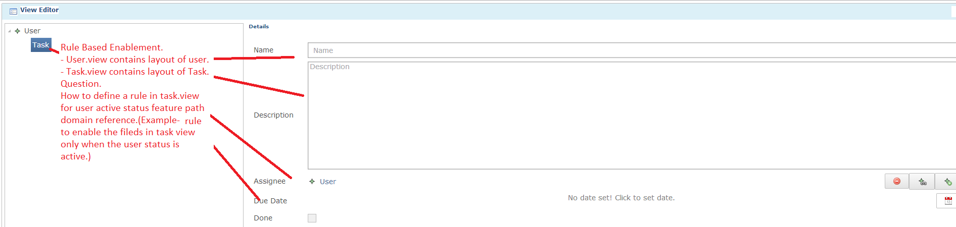

I have two view defined for entity user and task, want to add rule in the task view based on user entity.
* user.view contains the layout for user.
* task.view contains the layout for the task.
Q: How to define a rule in task view based on user active status feature path domain model reference.
example- rule to enable/disable the fields in the task view based on active status of user rule.
PS: User entity is the parent container for task.
index.php/fa/18705/0/
[Updated on: Wed, 30 July 2014 10:30] by Moderator

I assume that tasks are contained in the entity user? Domain Model
references currently do not allow to reference parent elements, if they
would, then rules would probably work as expected. A work around would
be to add a derived feature to the entity task, which returns the
desired state and also handles the case, when a task does not have a
user as parent.
best regards
Jonas

Hello Jonas,
Yes, the tasks are contained in the entity user.
I understand that currently its not possible to define rules based on parent entity. and work around you suggested with derived model will have huge impact in our case where we have a very larger set of domain model.
Please find attached the xps for few cases.
Should i raise a BR?
Ranjeeth
