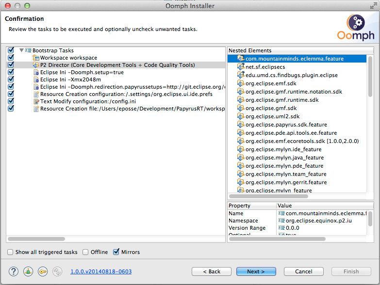

I select Eclipse Standard/SDK and then select the Papyrus UML-RT sub-project. (If I don't select any Papyrus components it works, but the problem occurs with other Papyrus components). Then after downloading a lot of things it stops with an extremely long stream of exceptions, which always begin with the excerpt attached in the error.log file, which is just the truncated setup.log (the full file is 4MB). This always seems to point to problems with "eclemma" sites, but it completely fails to create an environment: the resulting folder for the IDE contains only a sub-folder called "configuration" (with setup.log) and nothing else.
I also notice that three features are marked with an interrogation sign in the Oomph dialog just before beginning the bootstrap under "Nested Elements": one is EclEmma, the other one is "Findbugs" and I don't know what the third is (see attached screenshot).

It seems that the FindBugs update site at the University of Maryland
has gone off-line and the only way to install that plug-in now is by
downloading a ZIP archive from their SourceForge page. That isn't so
easy to integrate into an Oomph setup, so I have removed the FindBugs
feature from the Papyrus setup model.
Installation should now work again using the latest Oomph installer.
The question mark decorations on some of the P2 Director requirements
are just indications that these features are optional; if they can't be
installed for some reason, then the setup should just proceed without
them. The problem in the FindBugs case was that the repository was not
available at all, which resulted in Oomph failing to complete any
install.
