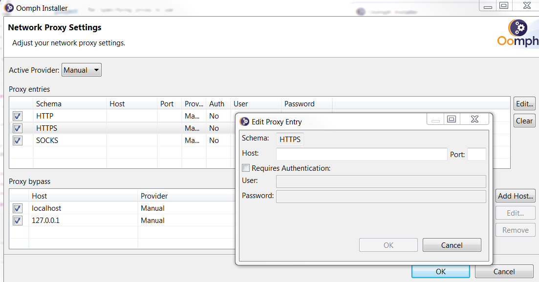

Boris,<br>
<br>
Never having used them, I'm not sure specifically what you mean.
For me, when I look at this dialog as I see it from a full Eclipse
installation and as I see it from the Installer application, I see
the same dialog with all the same abilities...<br>
<br>
Your statement seems to suggest there's something you can do with
the Eclipse launched dialog that you can't do with this same dialog
launched from the installer.   Is that correct?  Can you be more
specific about what's missing?  For me there is an "Edit..." button
that can be used to set the host, port as well as optionally the
user name and password.  It looks like this:<br>
<br>
<img src="https://www.eclipse.org/forums/index.php?t=getfile&amp;id=18641" alt=""><br>
<br>
<div class="moz-cite-prefix">You're not seeing that?  Or this is
somehow incomplete/insufficient?<br>

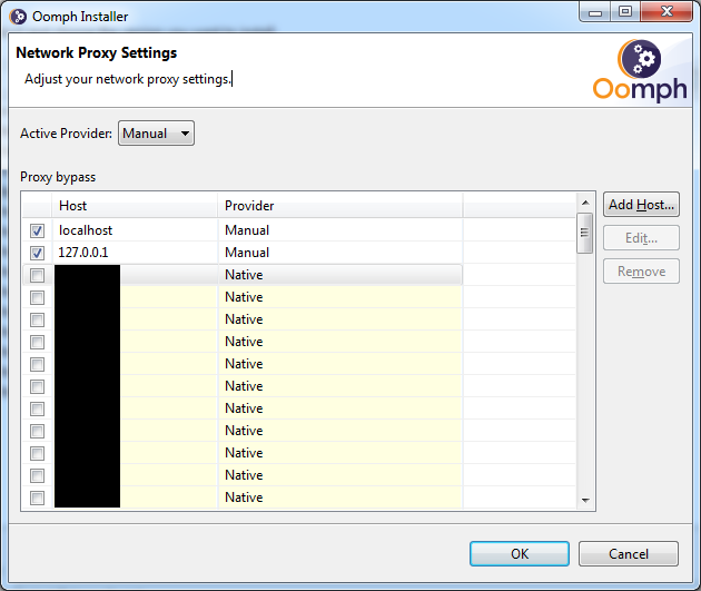

Hello Ed,
interesting, the proxy dialog of the Oomph-installer looks differently on my Windows 7 64bit (see attachment). The "proxy entries" part is completely missing! (I tried to resize and maximize the dialog window without success).
SWT layout problem?

Boris,
I'm also on Windows 7 64 bit so that can't explain it. Do you have the
latest version of the installer? This part should be created by
org.eclipse.ui.internal.net.ProxyEntriesComposite and even if the
initializeValues method didn't find any proxies, there should still be
an empty table...

Am 28.07.2014 10:58, schrieb Boris Brodski:
> Hello Ed,
> SWT layout problem?
Yes, definitely. Can you please submit a bugzilla?

It only happened if the second table had many entries, which for me it
didn't. It's fixed via
https://bugs.eclipse.org/bugs/show_bug.cgi?id=440561
