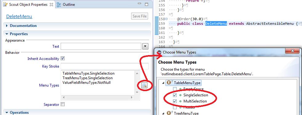

You need to change the types of your delete menu:
index.php/fa/18636/0/
I think you will need:
- SingleSelection
- MultiSelection
You also need to modify the execAction: use ".getSelectedValues()" instead of ".getSelectedValue()".
@Order(30.0)
public class DeleteMenu extends AbstractExtensibleMenu {
  protected Set<? extends IMenuType> getConfiguredMenuTypes() {
    return CollectionUtility.<IMenuType> hashSet(TableMenuType.MultiSelection, TableMenuType.SingleSelection);
  protected void execAction() throws ProcessingException {
    if (MessageBox.showDeleteConfirmationMessage(getNameColumn().getSelectedValues())) {
      SERVICES.getService(IStandardOutlineService.class).deleteItems(getIdColumn().getSelectedValues());
      reloadPage();
You will need to modify the signature of IPatientService#delete(..). It should accept a List as parameter. Of course you we need to adapt your implementation server-side.
